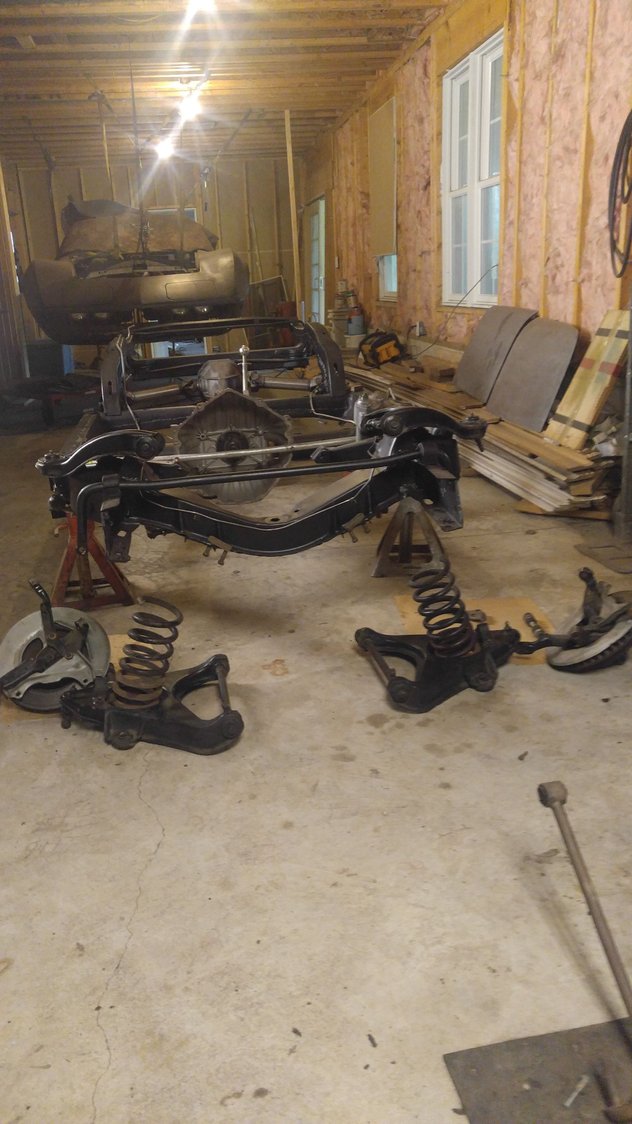

I worked on my frame in my garage which has a more or less 'level' concrete floor and used 4 jack stands to support it in many different locations.
I don't think I ever had an occasion when the stands were place symmetrically and the frame would 'rock' on the them.
The frame rails are indeed 2 sections welded together that result in a 'stepped' bottom surface, but places can still be easily found to locate the jack stands.
I often place the rear set of stands at the triangular 'fillet' at the step up of the frame rail for the t-arms.
Sometimes I'd use 6 stands which would allow me to remove 1 at the location on the frame I was currently working on.
Here's an example of a typical 4 jack stand placement.
Regards,

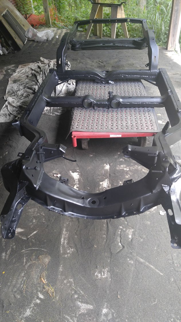

Same area but with a 'welded in' transmission cross member which was used with 4-speed transmissions. The 'bolt in' crossmember was used with automatic transmissions.

Originally Posted by Alan 71
Hi A,
The dent? No.
The sloped bottom of the rail? Yes.
regards,
Alan
Alan, your c3 frame is spotless, very nice!!
