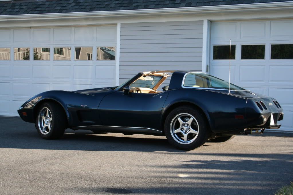

Do I love the look of the ZR1 style rims? NO but I have learned to live with it since the tires have transformed the car-handling, ride, steering response, braking etc. Folks that have ridden in my car are stunned at the suspension performance, not to mentioned the upgraded engine. If ever in RI, I will take you for a ride and make you a believer in the tires..
BTW-Had the 78 out today and smile every time...even with a C6Z06 in the garage...................
