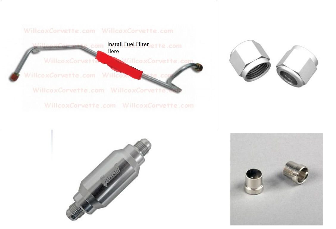

I'll try and run it to see if it ends up leaking out. Maybe I'll even JB weld or qwik steel the inlet to the body and run an inline filter because I'm a bubba
Speaking of an inline fuel filter, I'm in the process of fabricating an inline fuel filter using a new steel fuel line, a Summit 6an fuel filter and associated nuts/sleeves. Lars has a good write up for fabricating inline fuel filters.
http://www.lbfun.com/warehouse/tech_...uel%20Line.pdf
My plan:

@ green 71. Appreciate the tip. That'll be helpful when i get to that point
