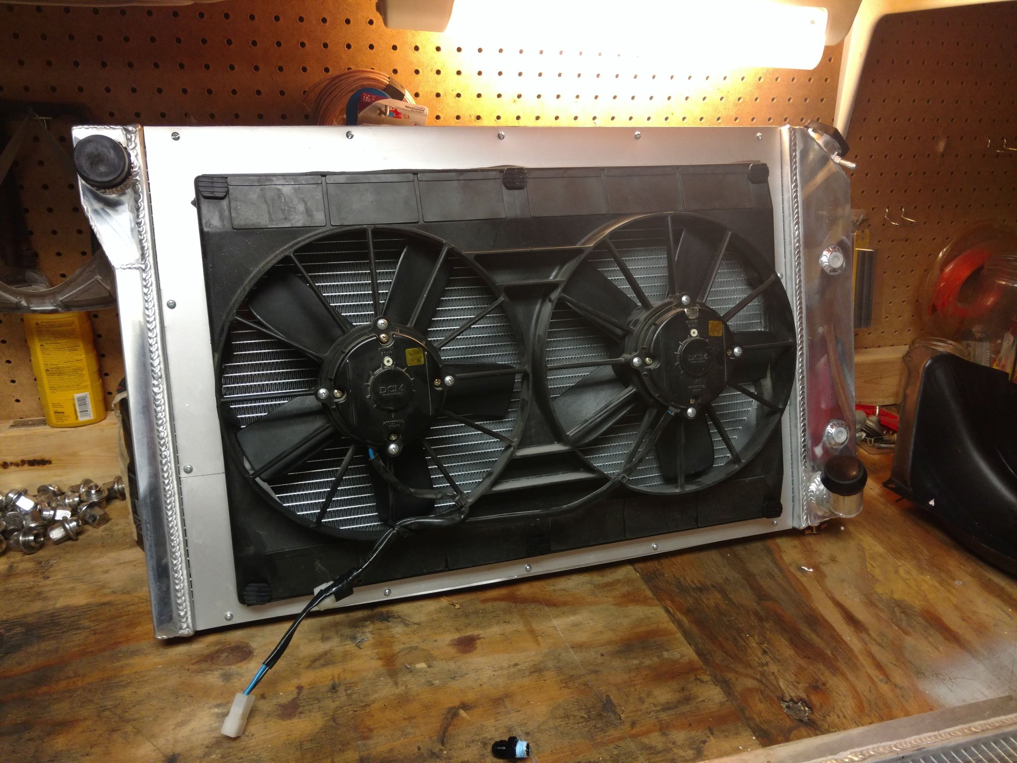

Old Aug 17, 2016 | 07:45 AM
Ydnar44's Avatar
Ydnar44
Joined: Jan 2016
Posts: 27
Champion 2 row aluminum
Let me start by saying I'm new here, but this set up works very good for me, radiator was 175$ from jegs
I like the extra aluminum shroud so no radiator is wasted very nice and thanks for the picture...
A non biased sticky on this subject would be nice to link to when a thread like this gets posted....
