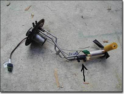

After I installed a 85 fuel pump and adjusted the pressure it ran for a while then stopped. Turns out the original factory hose burst. See image below.

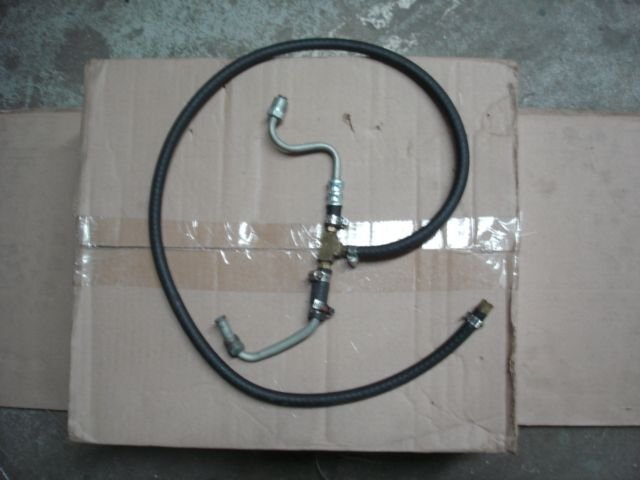

This is what I made for checking the fuel pressure on the Cross-Fire engines.

Old Sep 9, 2016 | 06:36 PM
terry82's Avatar
terry82
Joined: Jul 2000
Posts: 6,664
Likes: 162
From: columbia city in
Thanks dub .I have a choice I can go with what several others have done and put a pressure gauge inline of the fuel line between the tbs or I could do something like this http://www.bing.com/images/search?q=...9o0&ajaxhist=0 this way I could use a regular fuel pressure tester.I would like to find a way to do it with all metal lines no rubber connections.Thanks again for posting Its good to see others ideas.
Old Sep 9, 2016 | 06:59 PM
