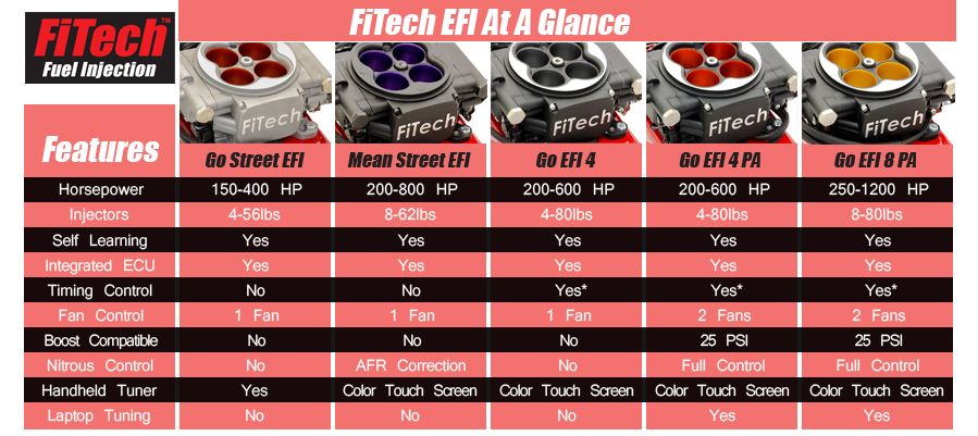

Stock L48? You can go with FiTech's base version "GoStreet EFI" for under $800. If you want to give yourself a littl emore growing room and a few more features, their "Go Efi 4" can be had for under $1000.
They are the hot new efi because they have the same features as the rest (MSD, Holley, Fast, etc.) for substantially cheaper. Lots of reviews on here and all over the net right now.

I'll have to do a bit more reasearch, obviously, but I can keep the mechanical fan, etc correct?
I'll need to upgrade to electric fuel pump, thought, correct?

Yes you can keep the mechanical fan and yes you will need to step up to an electric pump. FI needs more pressure and it cant pulse like a mechanical pump. Lots of systems out there. All work well when tuned correctly and setup correctly. I have run Mass Flo and Currently have an LS3 with pretty much stock computer and fuel system. I am running a Fast EZ efi 2.0 on my Cobra. Only 50 miles on it so ffar but it is learning and running well so far.
