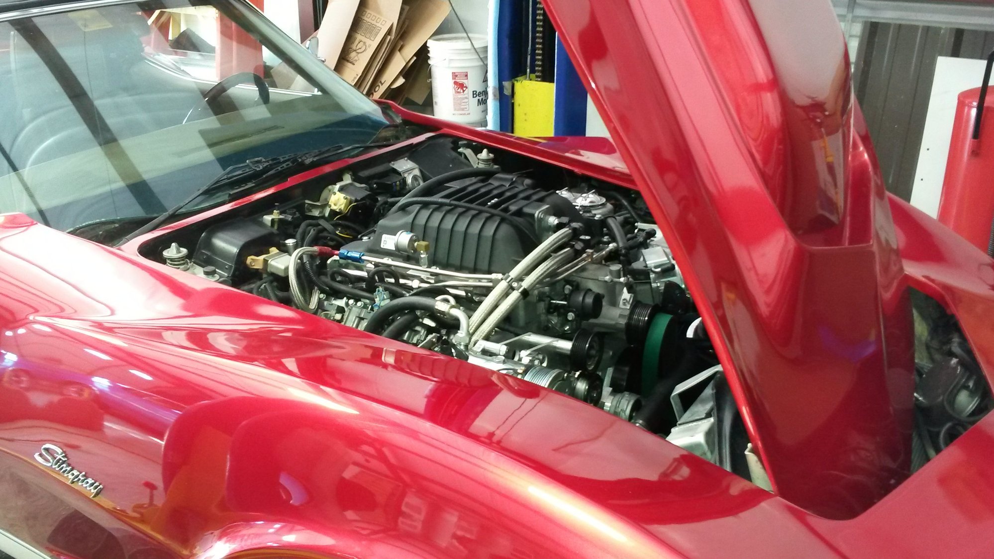

Many of these suggestions will have you spending enough money to DO an LS based swap, leaving to door wide open to pretty much anything you can vision....
To wake up a sleepy L48

Patro46 - How is an LS swap as cheap as swapping intake/heads? I'm not trying to be argumentative, but if it can be that cheap, I want to know how you sourced parts and would honestly start to plan for one.
My belief is that too many other things also have to change to make it as cheap as a gen 1-based top end (which is what the OP was actually posting about).
I agree that once it's done you have a great platform for performance - but aren't the total modifications required to run an LS in any C3 rather extensive?
I love the LS engine.......but the biggest deal killer for me is how it does not at all look like it belongs in a Vette.......I cannot totally explain it but Vettes were showcases for the best Chevrolet engines of the time......a statement that is true today......but the heart that beats in a vintage Stingray is vintage itself......
Just my opinion....and the reason I spent over 6k building a kick butt 406 that looks like is suppose to go there. My car would not be the same with a LS deal in it. Depends on the theme.....
Anyway...carry on
Jebby
Old Sep 9, 2016 | 09:14 AM
jb78L-82's Avatar
jb78L-82
Joined: Oct 2007
Posts: 7,455
Likes: 977
From: RI, Now Franklin/Nashville TN
Anyway...carry on
Jebby
I agree about the LS swaps..not my thing since to me that engine just not fits the theme...depends what you want though..its your car though to do as you please. I feel the same about 383 conversions but going to a 406 is a different animal
FWIW-my understanding from the engine builder (he builds big HP chevy engines and has done MANY) who did my bottom end of the L-82, commented that the .015 head gasket I used is good for about .2 compression bump, not .5.
