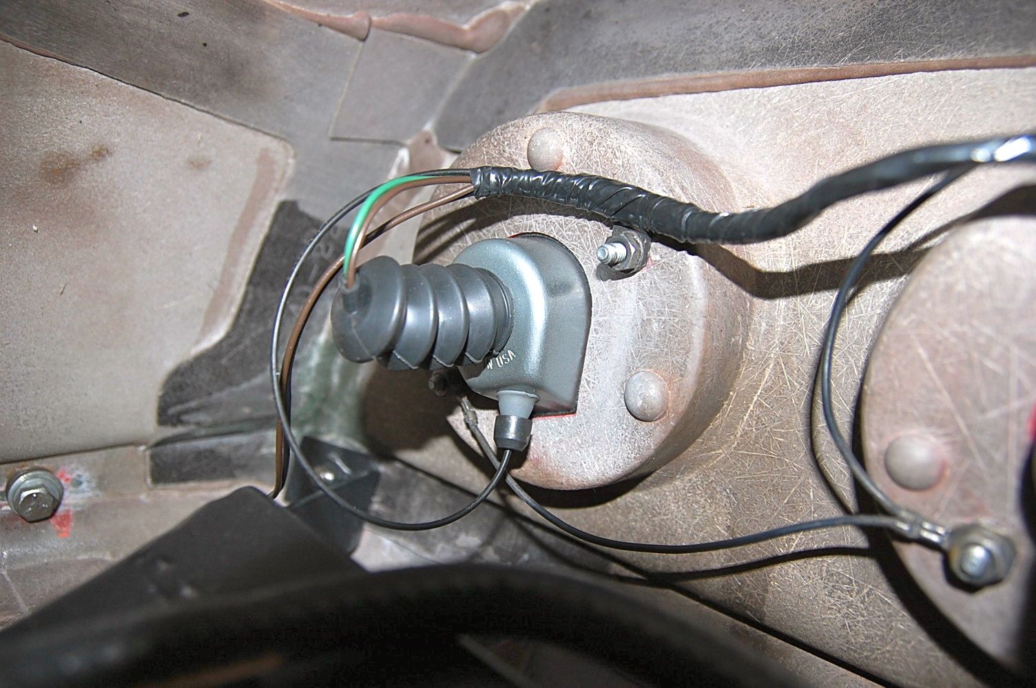

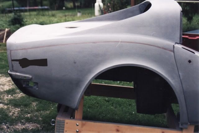

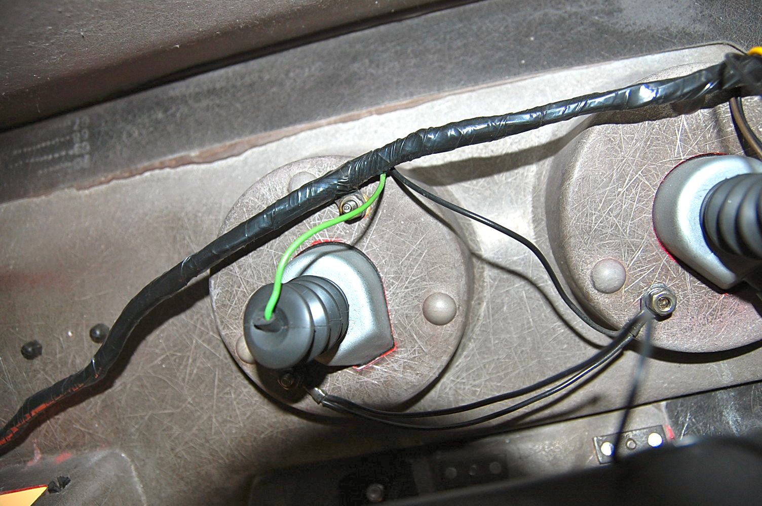

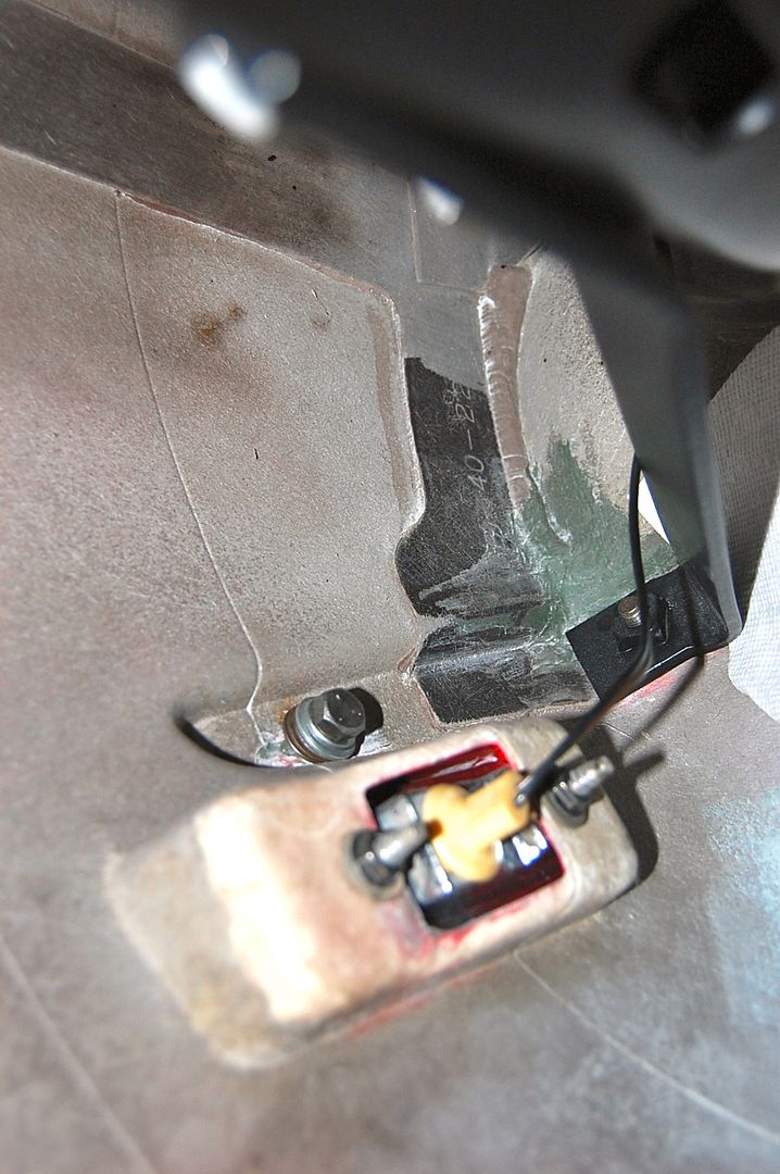

Hi 73,
Member DUB can certainly give you the information you'll need. He's generally along late in the afternoon and early evening.
Have you removed the paint and primer from the area so you can see the location of the seams and have you taken a look at the bonding strips under the the rear of the body?
Regards,
Alan
The seams from the exterior:
Bonding strips:
Lower right corner.
Upper right corner. Note corner strip is part of quarter panel strip!
Tailight panel to rear deck bonding strip across top.

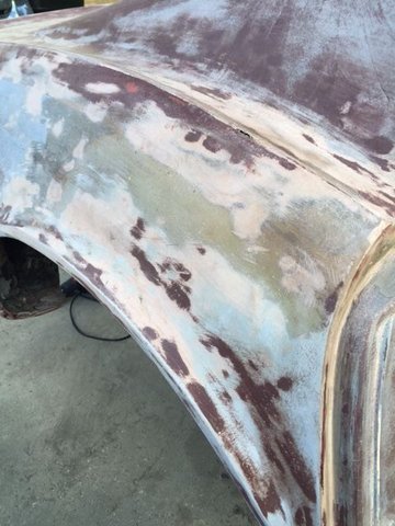

I had some success this afternoon. Tip of the cap to those who do this on a routine basis. Pretty hot and stuffy up in that rear well with the heat gun. I think there was some delamination of the bonding strip as I worked it off. I dont believe it's going to be reusable. I also think I'm going to remove the passenger side rear fender. Looks like the car was hit there. I see a repaired area plus gobs of bondo near the rear splash guard. The adventure begins.
Tan colored area is a repair, plus a hole near the seam.
It will be next week before I work on it again. I'll chime back in with questions I'm sure.
