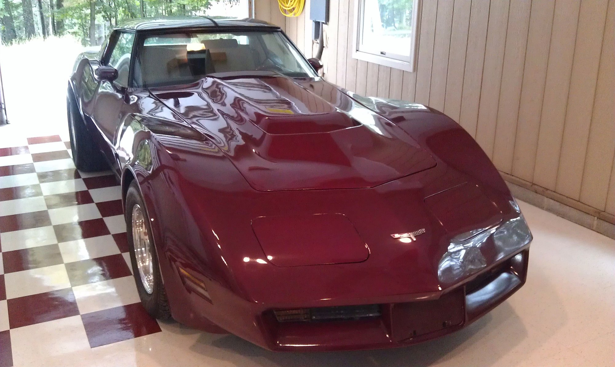

When I got my 80 painted, I did not want to spend a lot, and so I found a local guy working out of a pole building in his back yard. He told me in order to paint the car that he would need to remove the bumpers, paint separately, and then re install. I asked about just bonding on fiberglass new bumpers and painting the whole car together, and he agreed to do it for a little bit more, plus the cost of the bumpers. My total cost was $3800 for the job. Someday I'll have the car done right,....but for now it works for me.

Looks like he did a pretty decent job.

Very nice job!!! Is that Claret with oyster interior.

He was just a young kid trying to start a paint shop business. I figured he'd do better than Maaco, and he really did a great job for the money.
The color is dark claret, and the interior is doeskin. Here's a few better pics.
