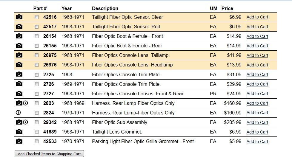

I don't think it would be that tough- but expensive.
Here's what you'd need- and a console.
I'm doing a total custom interior and made sure I kept the fiber optics!
Richard
You can also get all the tubes as a separate harness, front & rear. Getting them installed would be the fun part!
