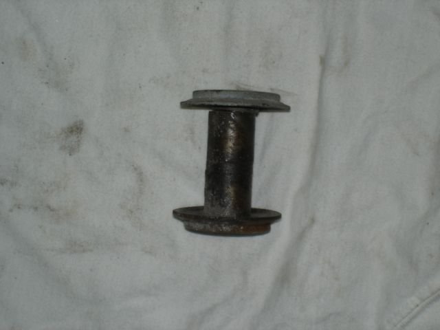

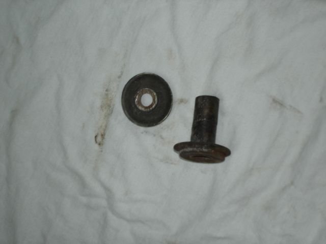

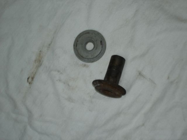

Obviously... I just put the two parts back together for the photo.
Not that this matters....but these photos are of a trailing arm bushing inner sleeve parts that I had cut out of a trailing arm with my Porta band as I have mentioned.
DUB
