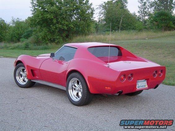

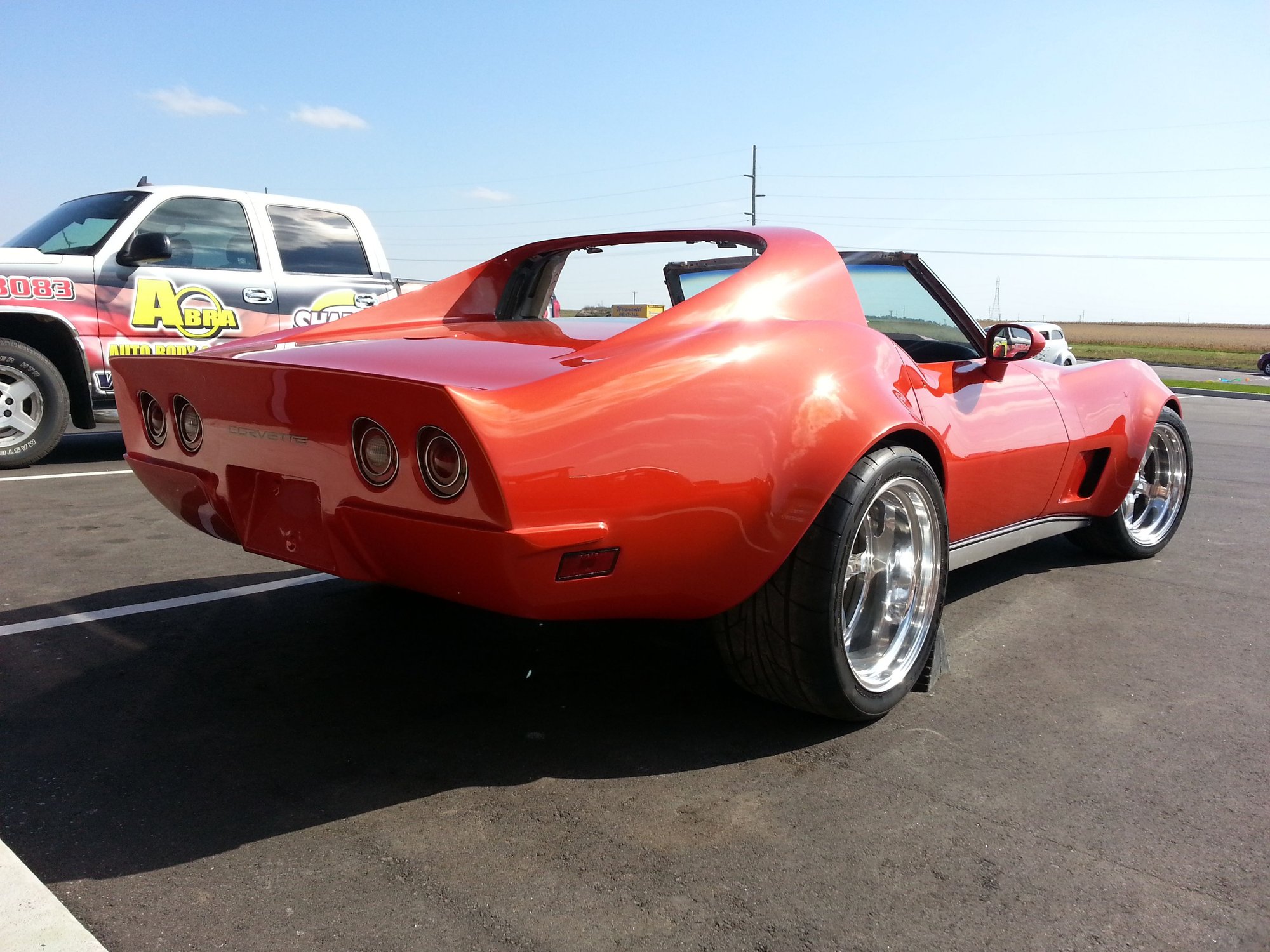

I'm considering a graft on chrome bumper style rear as shown in these two examples,
without the actual chrome.

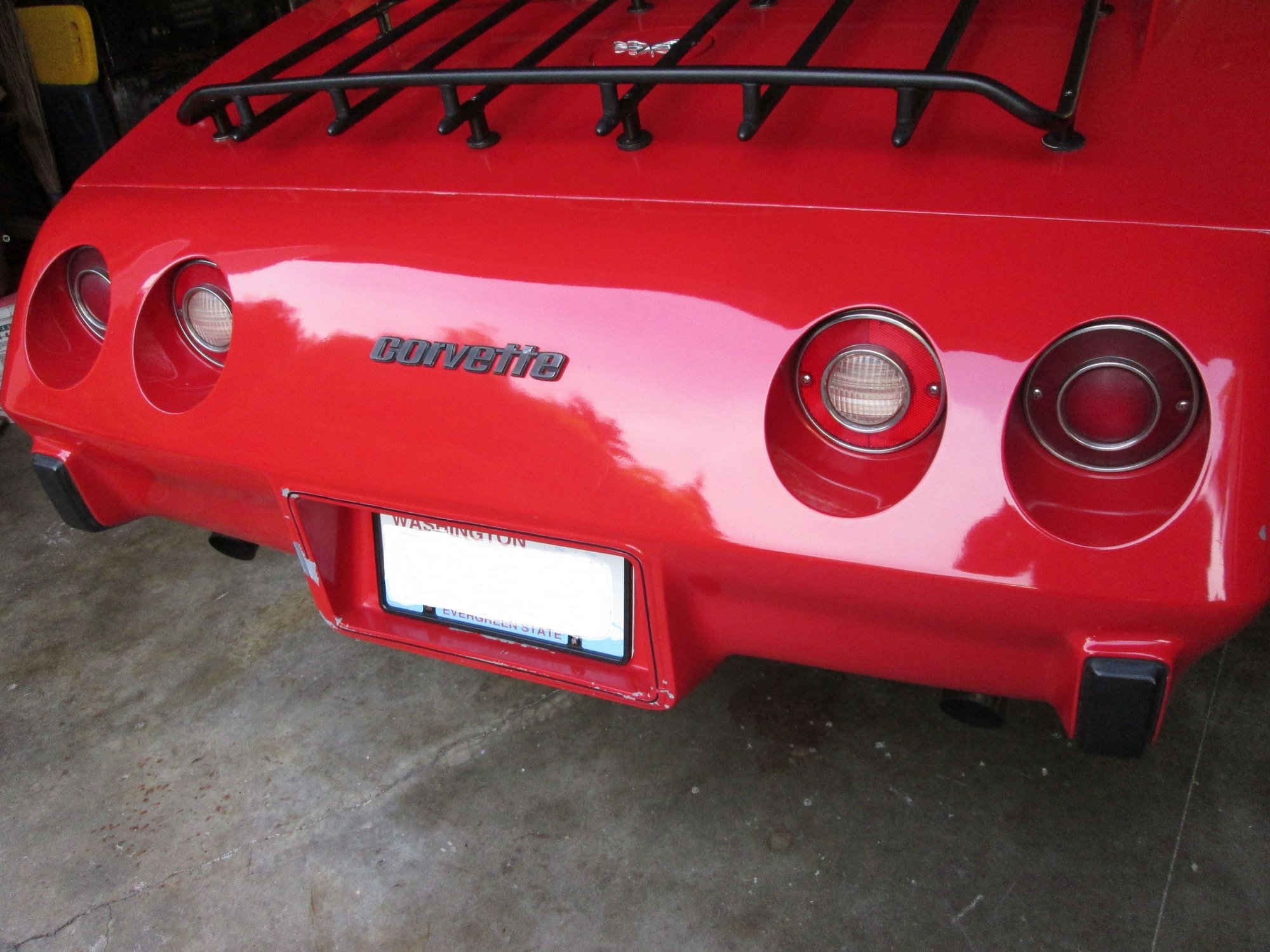

Here is my car, and a photo of the blank bumper. I'm not going to glass it in, and at the moment I'm trying to avoid another $250 for new lenses. I'm thinking the old '77 lights can be made to fit. Not a show car so I doubt anyone would miss the hooded lenses.
Steve

In looking at your pictures it appears your later lenses will work but give a slightly different appearance than the 68-73 lenses do.

I really doubt if the tail lights will fit. And will look weird if they do.
By the way, mine isn't a "graft on"; its a '73 with the bumpers removed.

68-73 tail lights are close enough in diameter to the later ones that it should not be a problem , the problem you will have is the later lights are about 3/4" deeper that the earlier ones and they mount different , you will need to deepen the buckets glass up some holes and drill some some new holes , but overall its not a huge job. i'm in the process of doing it myself
