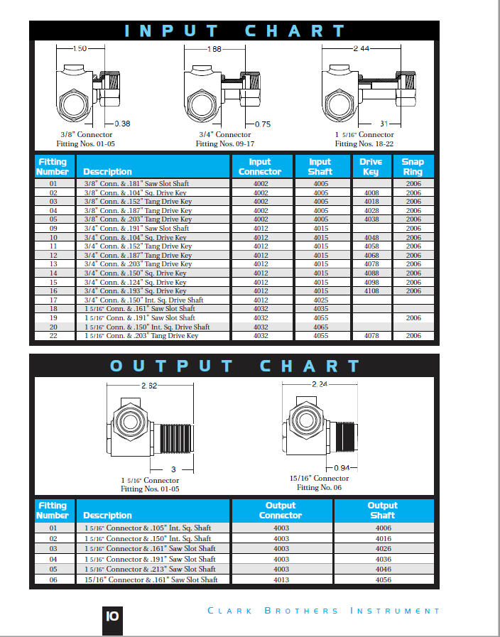

I received my right angle speedo adapter today. No part number on part or receipt, but it has “CBI” on the side, which I think from googling probably stands for “Clark Brothers Instrument”, and they seem to offer a wide range of 90 degree speedo cable adapters. Hopefully it holds up, it definitely offers much improved clearance to the exhaust.

Is that the stock 7/8" thread? I have found a couple, but they are all 5/8".
Edit: Turns out CBI is only a couple hundred miles away in the great state of Michigan. Their website has a great deal of options for right angle adapters, but I couldn't find exactly what I think I need. But maybe I don't know what I need. I'll email them and see what they say. I'll report back here....you know, for posterity.
