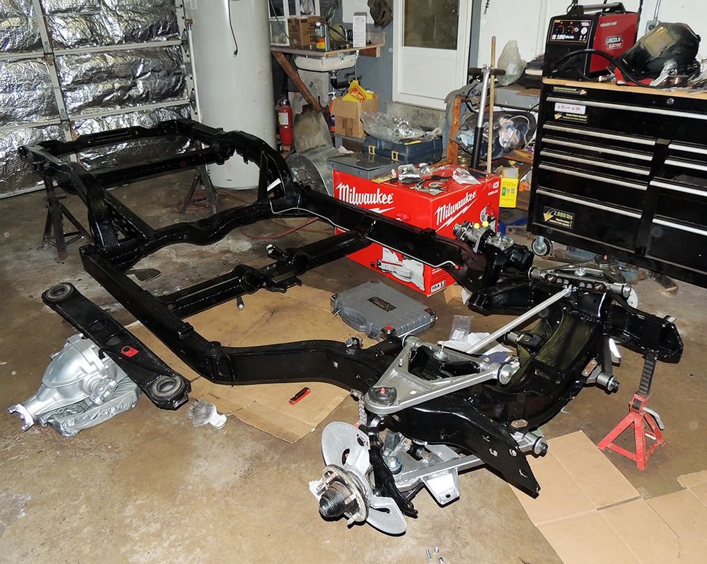

Originally Posted by clwi
A pic from the finished front end.
I believe you have the tie rods attached in the manual steering holes in the knuckles. Should use the PS holes. Also I suggest not using a rear sway bar. That includes the one in the suspension kit. It will make the rear suspension more compliant and reduce oversteer with it off.
Tom
You should be happy with the steeroids rack & pinion, but did you install a spreader bar? I have done all of that on my '69. Love the composite front spring, put the front suspension on in '93. Did the steeroids & spreader bar recently.

I have this setup on my 80, a little different than yours with mine having the batwing rear. Here's a few pictures. Nice to be able to easily adjust the front and rear spring rates, and ride height at each corner front and rear. Front rates 450, 500, 550 or 600 pounds, rear rates 300, 325, 350, 375, 400 and 425. I have Bilstein Sport shocks, but adjustable shocks would be nice with it. Firm ride, flat in the turns. I think I have mine set second in from the highest settings for both. All poly bushings too. Wheels are 17x9.5, tires are 275/40 ZR17 Nitto NT555 front and rear.
Spreader bar up front.

I have heard great thing about this set up and I am installing it now also.
I did not cut my frame.
In the pic you can see a spreader bar mocked up.
