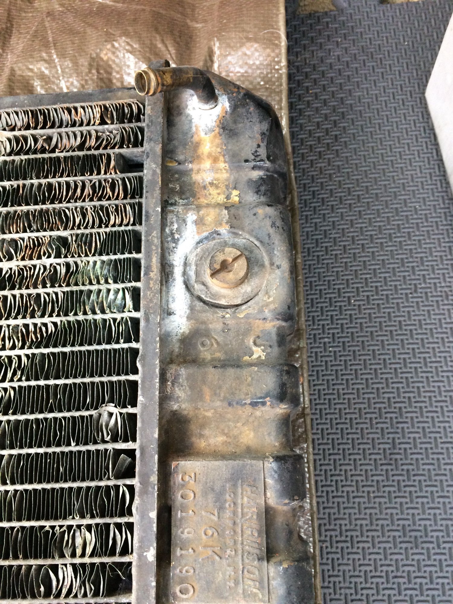

1969 big block 4 speed
My car came with lots of pieces and parts. This radiator was one of them.
All searches on line show this Harrison Radiator as a 3019190 as a 1969 to 1972 big block. The other number is 76K
Does anyone know if this means it is from 1976?? or does the 7 represent 1967? Are the brass plugs indicative of an automatic radiator?
Just deciding whether to recore this thing for $300 to help with my overheating issue or new Dewitts aluminium for 500
Thanks, Pete

that is a radiator made in December 1976

The info I have indicates the 3019190 was used for big block engines with automatic transmissions during 70-72 (maybe longer?) production.
I believe it became the service replacement radiator and thus has the date as MW indicated in his post.

69 big block rads had a removable metal identification tag that snapped onto the edge of the tank about a 1/4 inch to the left and in the same relative position as the tag in your pic. I still have my 69 tag but my original rad was not in very good shape. I replaced it with a Dewitt's and am glad of that decision. It runs cool, is of very high caliber workmanship, fits like the original and when ordered in black looks pretty close to the original.
Below is a pic of my 69 tag. It's spring steel and just clamps over the rad tank edge just to the left of the tag in your pic.
