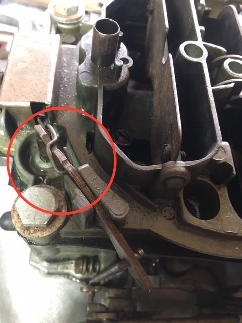

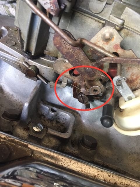

hi,
i'm restoring 1968 BB and have issue of carburator leaking fuel from top and sides.
please see attached pictures (marked in red circles)
any help or links on how to fix this issue greatly appreciated!
alex

The carb is leaking fuel out the throttle shafts because it is dribbling fuel out of the main discharge nozzles after shutdown. This drops fuel down onto the throttle blades, and it wicks out the shafts and onto the manifold. The reason this is happening is that your fuel level is way too high, as evidenced by fuel coming out the accel pump hole. This can be caused by any one or more of the following issues:
  • Bad float
  • Wrong Float
  • High Float
  • Bent/damaged float pin
  • Leaking needle/seat
  • Damaged seat threads
  • Float arms binding on power piston tower
  • High fuel pressure
  • Float needle clip installed backwards
...just to mention a few. The bottom line is that the carb needs a complete disassembly, inspection, and rebuild by someone qualified to do it correctly.
