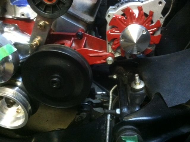

Parts of one I used the serp setup from a 91 fbody with my 79 PS pump with l98 PS pulley bolted to my 400 like it I came that way.

Kacyc3's Avatar
Kacyc3
Joined: Jun 2012
Posts: 1,990
Likes: 183
From: Port St. Lucie Fl
Old Dec 21, 2016 | 04:48 AM
kanvasman's Avatar
kanvasman
Joined: Dec 2012
Posts: 3,821
Likes: 1,728
From: Summerville SC
A picture is worth a thousand words Mr. Kacyc3. Thanks for taking time to upload them and I can see where some confusion is. My set up is from a Y body, 86 corvette, not an f body. When I first started this I was going to do the same as you have, but the accesories did not line up with the OEM water pump on the Y engine, they were off about 1/2". And once I decided to go with all Y brackets, I was locked into the Gen II pump w/ remote resevoir. So now I have eliminated using old style pump and I will go forward with seeing if MrVette's solution of just swaping out the pressure valve from old to GenII pump will let me use all the stock lines. Later today I will start looking for an old pump to pull one out of of. Thanks again for more help. Here is what I have
