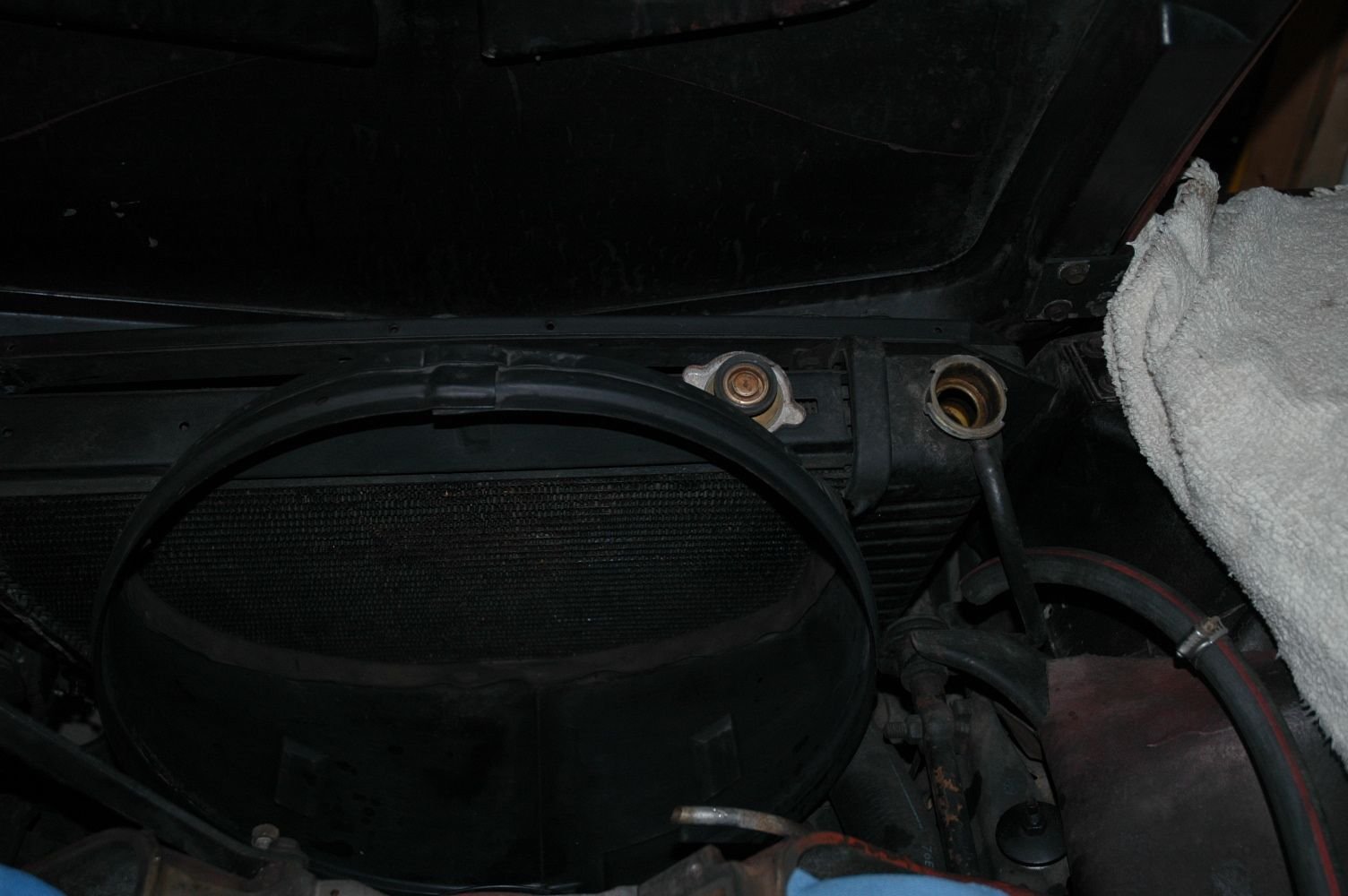

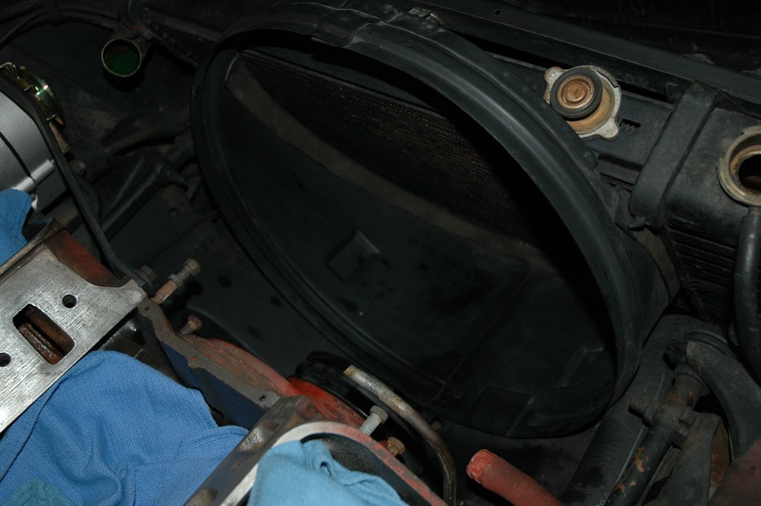

I wanted to thank you for those service bulletins concerning the overheating issues with our early 68 BBs.I purchased my 68 5 years ago and always thought I had an original engine bay but everything I read indicated fiberglass shroud.My car is vin 320 all original now (I think)after reading this post. I have the cut outs but no indication of ever having the deflector installed.Can you owners with original shrouds look at mine and confirm they look the same?

Jim
It looks to be the real thing to me. It's good to see a left alone original.
