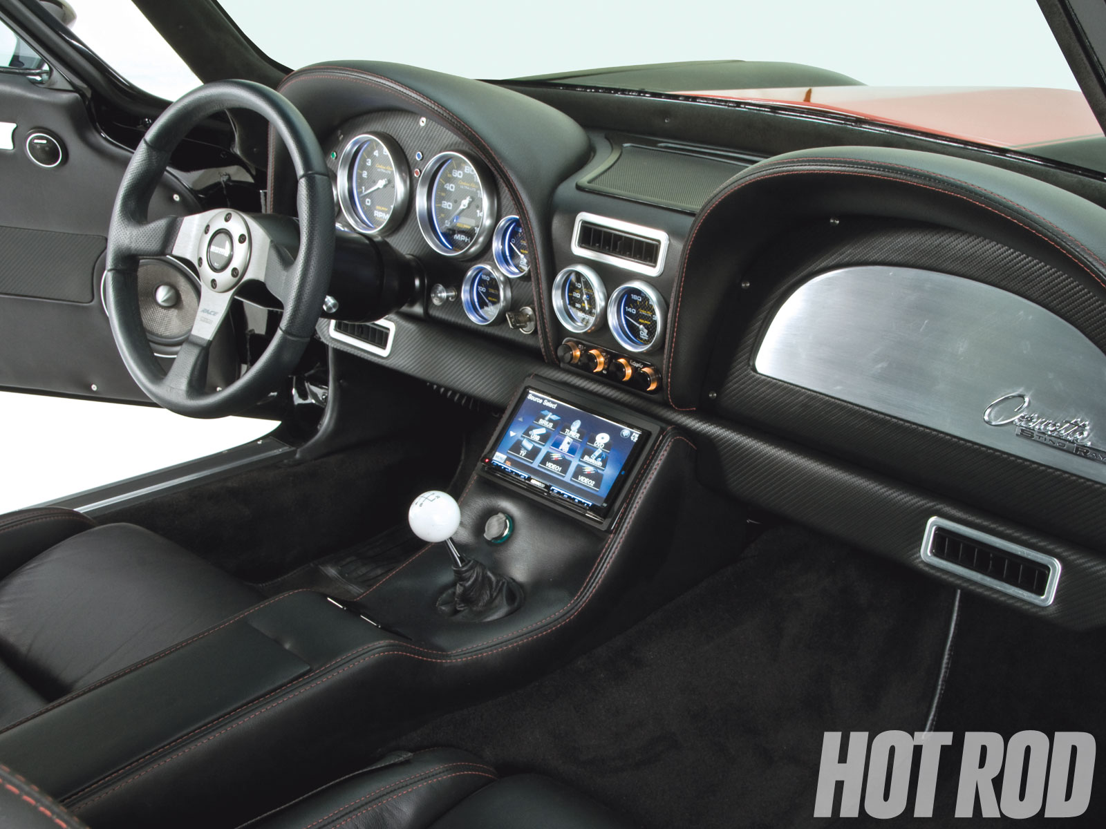

I was kind of thinking of this but with out the the passenger bump. Thats why I was thinking of the c5 cluster, but Iv moved on.<br/>

here's a thought- if you are looking for "that" kind of look in the custom C2- this might be right up your alley.
I have seen the C2 dashes fitted in C3's - so it shouldn't be that tough- but this is a great starting point- and then you could add your own custom gauges to it- about $900 for the fiberglass dash-

I can understand what you're looking for. To me, the individual gauges are incomplete because a complete dash requires a number of indicator lights and there are almost no aftermarket options for decent looking indicator lights. I did find these guys and they do sell nice looking indicator light strips.
http://newvintageusallc.mybigcommerc...icator-panels/
Have you looked at the various Dakota Digital dash clusters? Something there might fit your plans. These gauges include the indicators and 1 or 2 display panels for a more modern feel compared to individual gauges.
As for the C5 cluster.
The tach and speedometer require PWM signals from the PCM which is only available on a few of the late OBDI PCM's but available with any of the commonly OBDII stuff.
The other gauges use sensors and I think they'd work with older sensors that fit a gen I block since GM doesn't like changing the electrical operation of their sensors, just the packaging.
The fuel gauge uses a signal from the PCM so it wouldn't be easy to make it work with any other EFI system.
The display won't work right unless you have the compatible PCM, BCM, ABS and TPM systems in the car. Otherwise, you will have missing info or constant warning.
