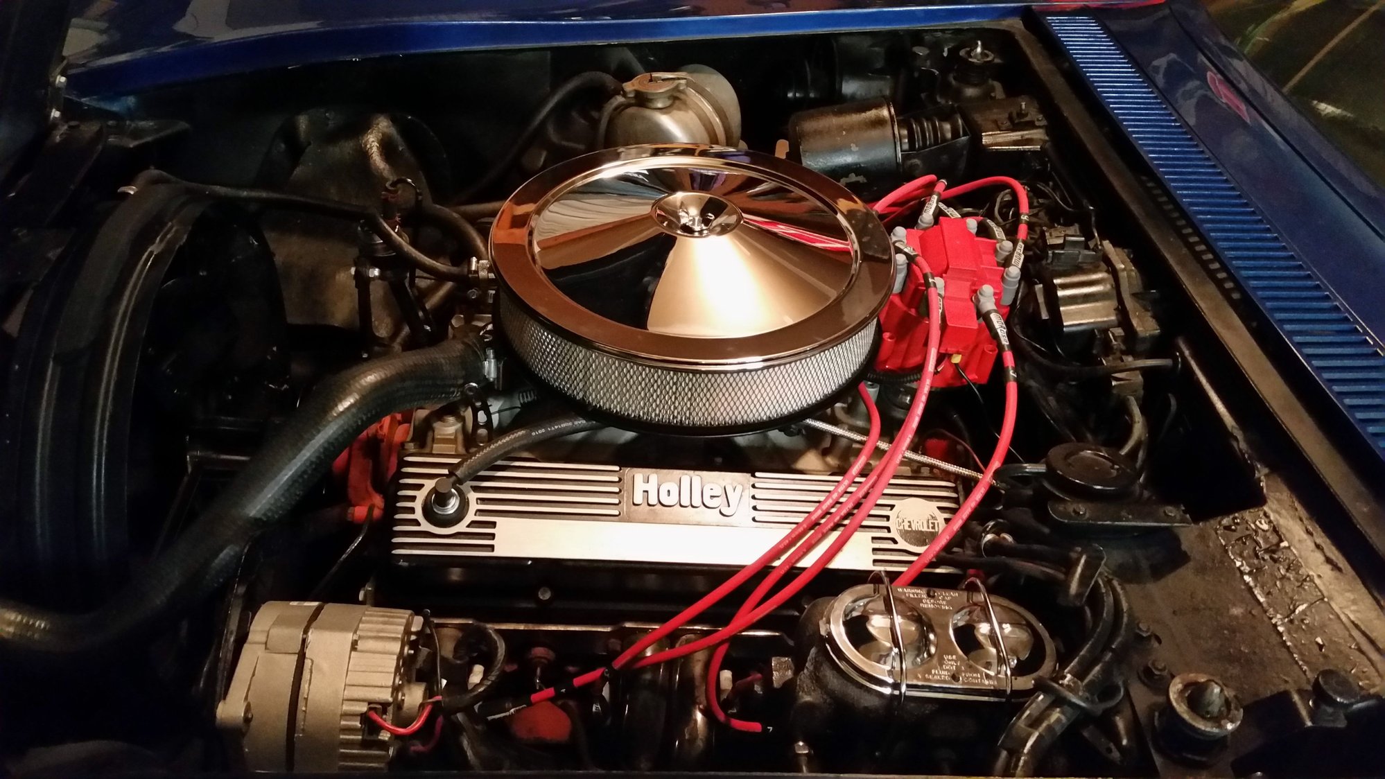

I installed a full kit this fall in my '69 small block. Went well once I figured out correct orientation of #1 lead around the clock to get timing to a starting point.
The only issue I encountered was some strange electrical interference that started as stereo cut-out when engine was running (not RPM-related whine).
Lot's of work to try to shield the firewall inside with foil, used choke filters on the stereo wires, and the problem stopped (not sure what actually killed it).
What it related to was some weird air-borne voltage transmission that would come and go. I could get jumpy voltage readings on my multi-meter, even with the leads disconnected but hovering over the engine bay. When this would happen, the stereo would do its cutting in and out trick.
That phenomenon stopped, and may be attributed to getting the plug wires organized with the billet aluminum wire looms I put in since this photo was taken.
May be attributed to the cheapness of the HEI, putting out strange interferences, but never was 100% sure of the root cause, or why it went away!
FWIW.
