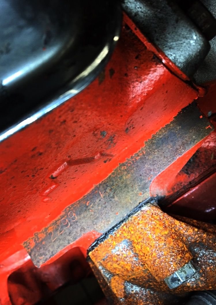

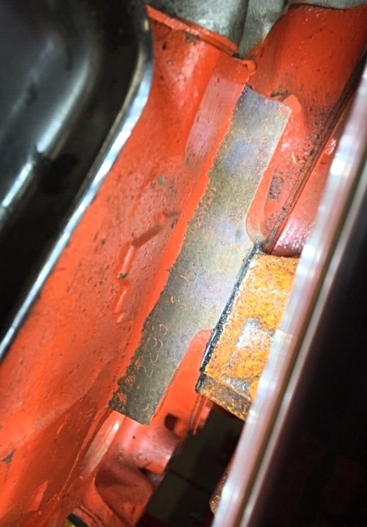

Old Jan 9, 2017 | 06:58 PM
72Shark_VAL's Avatar
72Shark_VAL
Joined: Oct 2016
Posts: 164
Likes: 14
Alright guys this is what I'm working with...doesn't look promising. Let me know what I can do if It's possible to be improved. All I can read is 2299 & possibly a 3 6 further over to the right.

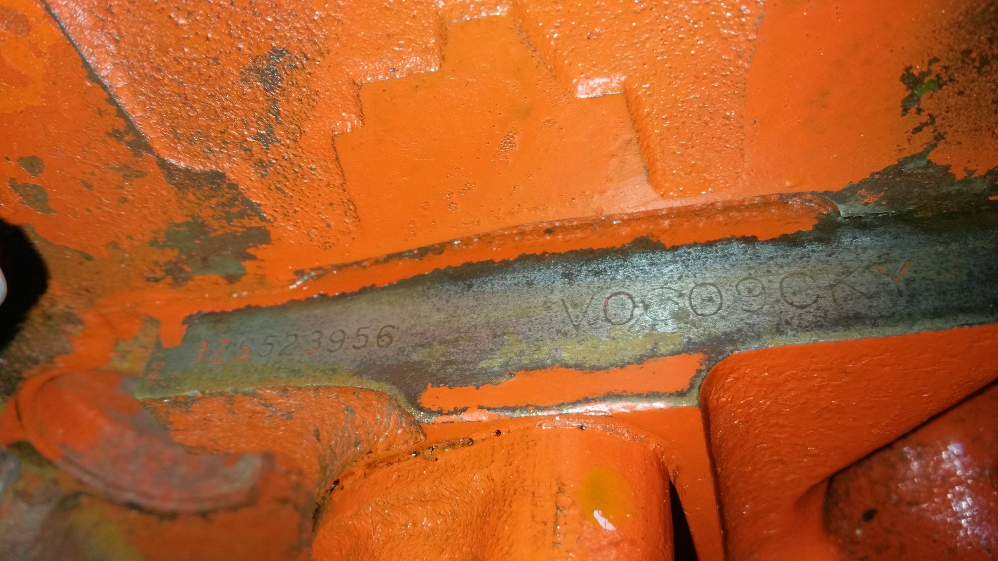

I see a 3 and a6 after the initail stamp.
this is how my stamp 72 looks, so Im not sure what yours is from without the build code. You could try raising it with some white paint on a rag to high light any stampings. Then if all else fail try the weak acid as a last resort.

Would it be smart to sand off the surface rust, hit it with degreaser, then try the white paint? The paint wouldn't just cover it up?

Dont sand it, any scratches will make it harder to read and some people don't want to destroy the broach marks from the original machining.
just put a tiny bit of paint on a rag and rub it into the surface, then wipe it of with a rag damp with acetone on it. the idea is to fill in any depressions on the surface and wipe the surrounding area clean. The block looks pretty worn but this process can bring out any thing that can be barely seen. If you want to clean it use a degreaser then a paint remover with a nylon bristle brush to get all the depressions clean.
another method would be to cover the tab with a very thin piece of paper like tracing paper and do a rub with a soft pencil very lightly like doing a gravestone rub. any depression will not transfer the lead of the pencil, but you have to go very lightly

Hi 72,
The 2 stamps on a Corvette sb engine pad were done at 2 separate locations, (Flint and then St.Louis), using 2 different 'gang holders', and at 2 different times.
The 2 stamps were, however, done in typically 2 SPECIFIC areas on the pad.
On your pad the larger stamped digits (the size used for the assembly stamp) are in the location that the smaller derivative digits are typically located.
I'm not saying this couldn't have happened but it's not something I've seen.
Perhaps someone with more experience looking at sb pads will voice their thoughts on the pad and stamps.
Regards,
Alan

FWIW: Looks like the engine pad is not going to be any help with solving the mystery of what you've got.
