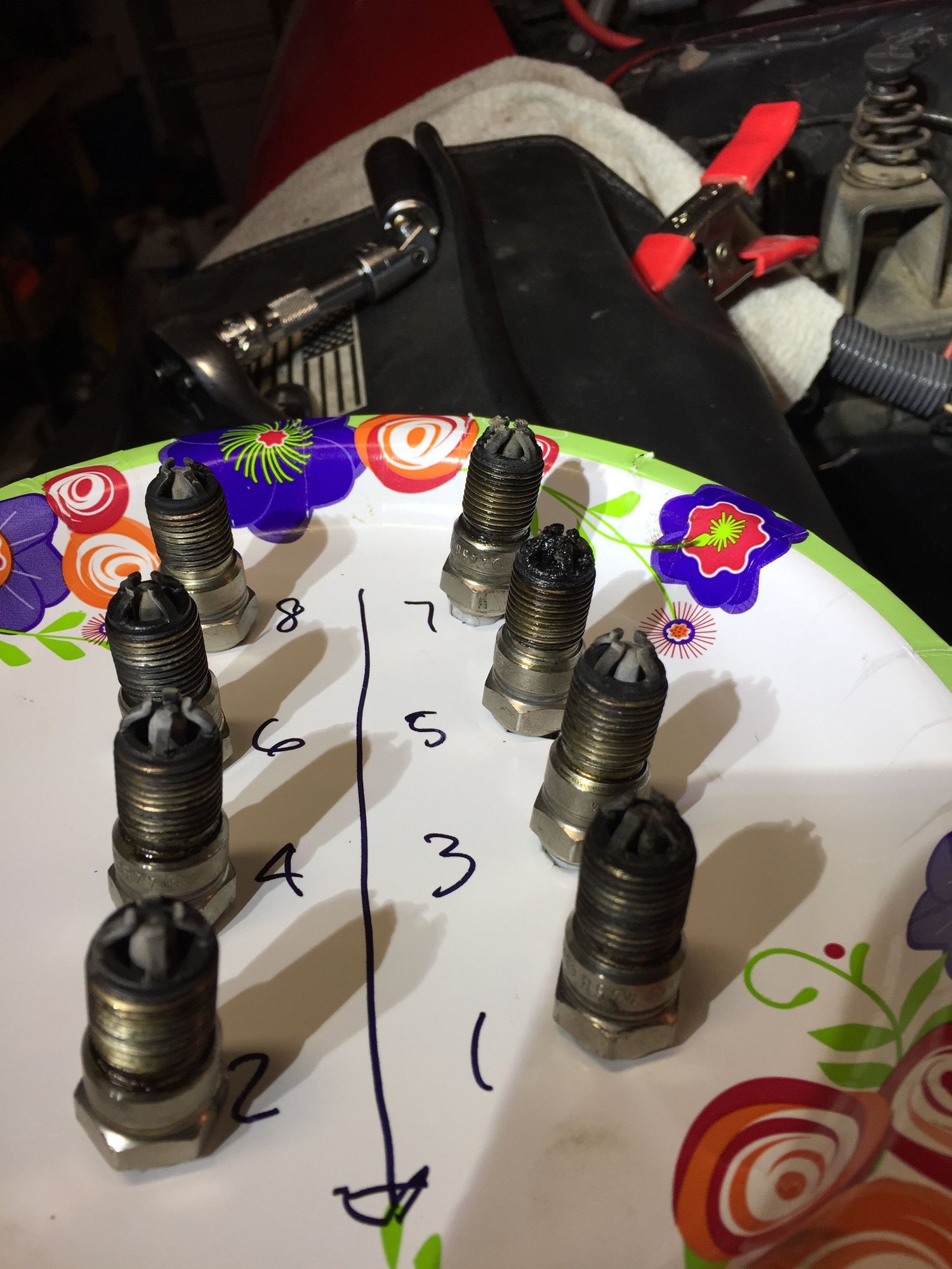

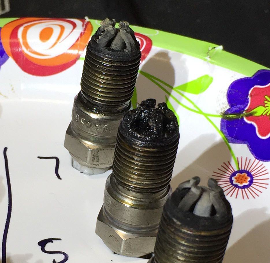

OK, so I decided to pull the plugs yesterday to check things over. Most were fine but two of them (#5 and 7) look horrible. Here is picture:
History: Crate engine about 12 yrs old, 350/290 with 2 yr old Vortec heads, Comp cam, Eddy 650 carb. Runs great.
I'm not sure about #7 but #5 looks real oil fouled. What are your thoughts on those?
Thanks
all the plugs
#5 and #7
I was planning on doing valve seals this winter so that is already in the works.

Change the valve seals. Easy enough to do.
If it isn't the valve seal, then................crap.
It "could" be the intake gasket sucking oil, but not likely if it runs well.

Your engine is ingesting oil from somewhere...and it's not the entire engine--just some cylinders. This could be an 'electrical' problem with the ignition (bad plugs/bad wires), or it could be 'mechanical' (rings/valve seals). Personally, I don't think that it is ONLY valve seals, if it is a mechanical problem.
The engine appears to be running rich, in general, but that's not fouling the plugs.
A source of excess oil could be a PCV system problem, such that it is sucking oil splash from the valve cover into the intake (but that should show up on all plugs or on one bank of plugs [w/dual plane intake].
Check for ignition problems, evaluate PCV system; if necessary, do a PROPER cylinder leak-down test to assess mechanical issues.

Yes, the heads are only 2 years old (summit vortecs) so it would be strange that the seals would go bad already, especially on only two of them. But I will check/replace them.
I will check those wires as well, these are also new.
Yes I will do a leak down test also. Thanks

That's the best thing you can do to tell you what is going in inside the engine. Everybody says compression test first, but, leak down will tell you more.

Yeah, that looks like oil fouling. If I had to put money on the table it would be on rings or a holed piston. It is better to find out sooner than later because it will only get worse.

Could it possibly be #5 and #7 wires were crossed? That's easy to do, BTDT
(Although I don't think it could cause that much crud unless it was leaking oil).

Misaligned intake gasket

We have a winner. That is what I think too, it probably sucked the intake gasket from underneath so it is pulling oil from the valley.

I will definitely check the intake and also replace the plugs. Thanks for all the help and suggestions. I have a couple things to finish up and I will get back to this and let y'all know what I find out.

how does the PCV hose look - You may be pulling oil in through the PCV system.
Disconnect the PCV and put in a breather - run it a few days and check the plugs..
The new PCV valves are junk..
