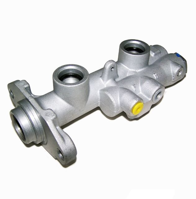

AND...not meaning to make you think I am stupid for asking this...but are you sure the Willwood master cylinder is made so the lines that attach to it are like they would be on your era of Corvette....because....the photo below shows how they can be installed backwards...due to how the master cylinder is designed.
Because IF the master cylinder is designed like the one in the photo above...then it is actually your FRONT line is not releasing...even though it is going to the rear...and thus...the master cylinder may not be correctly adjusted if there was some specific dynamic Willwood requires.
