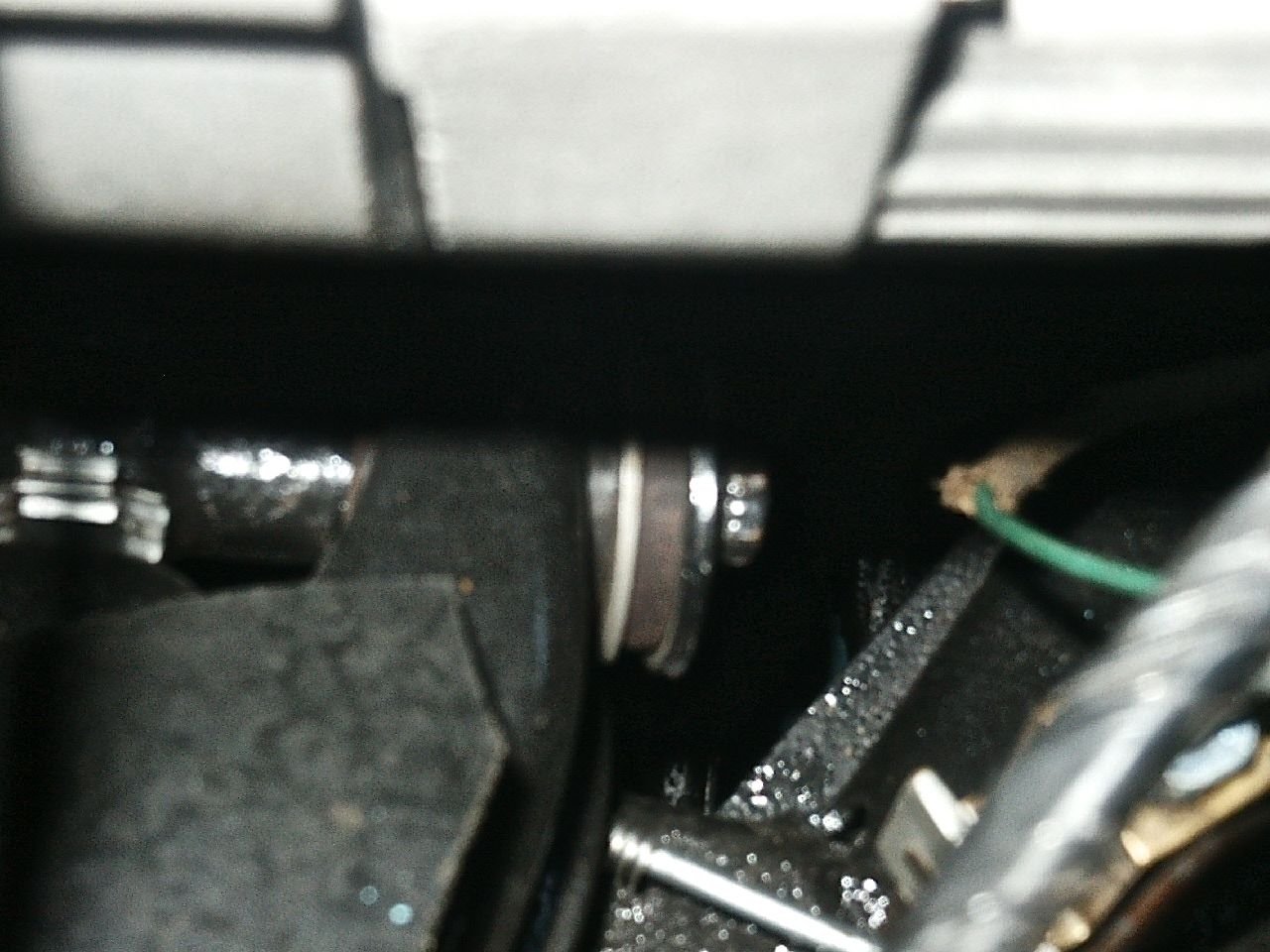

I got my bushings from Corvette Central. It was the complete
set of upper and lower bushings. These are the upper correct.
http://www.parts123.com/corvettecent...&searchtype=50
I just went out and took this photo of my upper bushing on the driver
and passenger side. I have had these on about 3 years.
Edit: Better photos from this morning.
Like I said, this is just my experience.
Donnie

Just pulled it out, with the forward Cup Washer and it's Bolt falling to the garage floor as the Rod came out and cleared the Radiator Shroud. The aft Bolt was in, but took very little torque to start it out of the Rod.
Steve

The installation was completed yesterday, with these details.
I removed the Fan Clutch from it's Pulley in order to remove the Radiator Shroud.
I made a larger cutout in the Fan Shroud, in the area of the upper A-Arm Pivot Shaft's End Washer/Bolt area. As mentioned earlier, the Washer/Bolt completely backed out of it's shaft hole and fell to the floor when the Shroud was removed. The bolt can now be observed with the larger cutout.
Clearance of Shroud to Pivot Shaft Bolt is so close on the Driver's side, it makes me wonder if the car might have had an accident there earlier in life.
The removal of the upper A-Arm would have been easier if I had removed the Alternator. All I did was loosen it and removed the belt.
The hardest thing in this whole job was installing and tightening the A-Arm Pivot Shaft's Shim Bolts. The Shims would fall out as the Bolt and self-locking Nut was tightened up. Was able to do this step alone by ratcheting up the bolt to an estimated gap of what the shims would fit into, then snugging the shims in place and then finish the torqueing sequence.
Installed the Pivot Shaft's End Washer/Bolt with "Blue" Loctite, and torqueing them only after lowering the car and bouncing the front bumper up and down a few times.
On the test drive, the car now drove amazingly straight, while before it required a bit of right turn input of the Steering Wheel to maintain a straight track. Also, the Bushing replacement eliminated the left turn "clunk" I was experiencing and couldn't figure out it's source.
Thanks to all who gave suggestions and encouragement. Hopefully my results will be better than those in the past.
