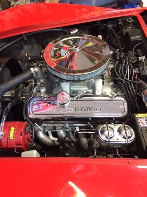

Yesterday I finally got everything back together on the 454 NOM in my 68 convert. Thanks to all for advice on selection of parts and trouble shooting on the mystery engine from the PO that came in the car. Final assembly: ProMaxx aluminum heads assembled by Shaw City Engines, Lunati Voodoo hydraulic cam (273/279 .542/.555 lift), Weiand Stealth modified dual plane intake, Cloyes timing chain and gears, CompCams push rods and guide plates, Holley electric fuel pump, Jegs ss roller rockers (from PO), Hedmann headers (from PO), QFT double pumper, mechanical secondary 780 cfm carb (from PO), flat top pistons .030 over (from PO), old school point/condenser distributor, Accel plug wires with ceramic ends, ARP head bolts and misc fasteners, FelPro gaskets, etc, etc, etc.$$$$. We got a break in the rainy weather here in northern VA, so I got to drive the car and it is noticeably faster than before. Will take it for a dyno run next week. Dyno run before starting work was 304 rwhp. I am hoping for at least a 100 hp increase. Fingers crossed.

Congratulations! I think your estimate is very realistic. I lived in.fairfax city and grew up in Annandale so I know your weather very well. It's nice to see a.big block Vette burning up the roads up there like I used. To. We used to street race on the Dulles access road and the airport cops would come out and bet on us. My 68 L-88 roadster beat a turbo Porsche so bad one night he just kept on going.
I wish you many miles of happy driving. Now take a run up the skyline drive!

While you are getting the dyno done see if the 2.5" filter has an impact. If not I'd love to swap intakes and go with a lower filter.
I added a dropped air cleaner bottom piece (K&N part 87-3549) to give hood clearance. It drops 1 1/4 inch so the wing nut would not hit the hood. The PO apparently forgot about clearance, since there are spider vein cracks in the paint where he slammed the hood on the wing nut. I had this setup when I had it dyno-ed last time. Even with the bb hood there is not enough room for a three inch thick filter with the intake I have.

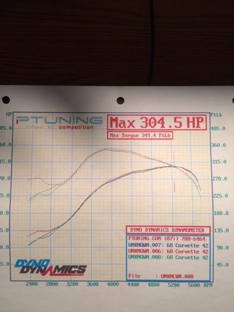

Default disappointment at the dyno
first dyno run with cast iron heads. November 2016
Car on dyno
printout of results
Well the dyno run was not as expected. Power curve was more aggressive than the run in November, but at 4800 rpm fuel starvation killed the power. Now I have to figure out where the choke point in the fuel delivery to the engine is located. Will change the fuel filter, replace the Mr. Gasket 1-6 psi fuel pressure regulator that came with the car with one that goes higher. The electric fuel pump is 130 gph, so that should be OK. Rats.

Did you remove the air cleaner for the dyno pull? That tiny air cleaner is KILLING you.. Having the lid sitting that close to the venturies and vent tubes will choke it to death.
And yes, the old mr gasket chrome **** fuel pressure regulators are complete junk, you need to get rid of that. IF anything, us a $25 Holley regulator.
I did have one run without the air cleaner and it did not cure the fuel starvation problem. I have on order a K&N air filter top with the pleated filter in it to add more filter area. The A/F ratio dropped like a rock at about 4800 rpm, like someone pinched off the fuel line. Holley has a regulator with a fuel return line port for about $80- think that is the one I'll get. I will also trash the fuel filter, which is a hose barb type like the stock Chevy filter with the return line built into the filter. It may not be plugged up, but may be sending most of the fuel flow back to the gas tank. I can run the return from the regulator and put a high flow filter in the line to the carb.
I did like the slope of the power curve, which is more aggressive than the previous run- until 4800 rpm.

Things to check:
1) Fuel sock on the pick up in the gas tank. I actually just reached in there and tore mine off by hand it was so bad.
2) Fuel hose from the fuel sending unit to the hard line on the frame, make sure that hose is not swelled shut or plugged.
3) Fuel filter, especially if its on the suction side of the pump.
4) Some holley fuel pumps to not require a return line, and thus may not have enough volume to feed the engine if you are running a return line.
5) The Mr G regulator has got to go.
6) Maybe your pump is just weak.
You really need a fuel pressure gauge on the fuel line at the carb that you can watch while making a pull to see how bad the fuel pressure is dropping.
Lastly, make sure your floats are set right and working properly, verify the rear needle is not stuck closed. Remember the carb can cause fuel supply issues also. You need AT LEAST 3/4" gap between the vent tubes on the carb and the air cleaner lid.
FWIW, I dyno tested a K&N Extreme 14" air cleaner lid and it gained no power and actually chopped up the fuel curve some, it seems to create turbulance across the boosters or something, at least on mine it did.
The best air cleaner setup is the factory/repro L88/LT1 2" drop base, with a 3" filter and matching lid. This will get you some clearance above the vent tubes but still fit relatively low. This will clear an L88 hood with a Stealth or RPM air gap intake.

Unfortunately I kept some of the PO stuff in place when I added my electric fuel pump. The pressure regulator is AFTER that GM fuel filter with the return line. I suspect that much of the fuel was sent back to the tank. New plumbing should correct that issue. Plan B, if needed, is to just eliminate the return line.
