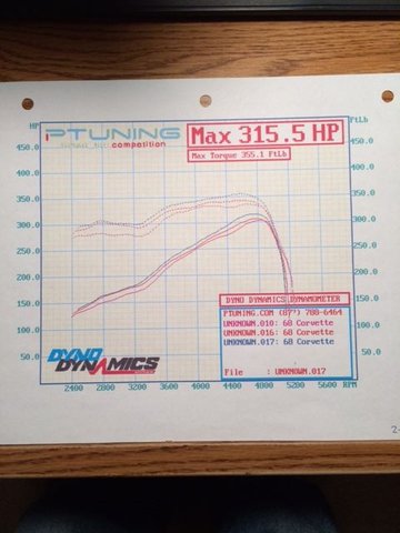

first dyno run with cast iron heads. November 2016
Car on dyno
printout of results
Well the dyno run was not as expected. Power curve was more aggressive than the run in November, but at 4800 rpm fuel starvation killed the power. Now I have to figure out where the choke point in the fuel delivery to the engine is located. Will change the fuel filter, replace the Mr. Gasket 1-6 psi fuel pressure regulator that came with the car with one that goes higher. The electric fuel pump is 130 gph, so that should be OK. Rats.

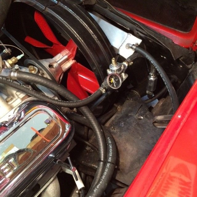

Holley bypass regulator and Jegs fuel gauge and billet filter
Originally Posted by USAFVeteran
Here's how I mounted my regulator. I made a bracket from a steel "L" angle and bolted it to the head, and the regulator. I just put the one from the other side for the P/S reservoir for giggles.
USAF- You were much more creative than I was. I wanted to keep the regulator away from conducted engine heat, so I simply bolted it to the fan shroud. Plenty strong and cool. Unlike the previous setup with the Mr. Gasket regulator from the PO at 2 psi, now I get 9-10 psi. My wideband gauge finally got here and I get between 13.0 -14.0 thru the rpm range from 1500-5000 rpm. I'll let the dyno go up to redline, but it appears the restriction was in my previous fuel line. Ihope to get dyno time this week.
If your fuel supply is relatively steady during the pull, you are likely going to have to jet up the carb as you are pretty lean still... Ofcourse 13.0-14.0 is a broad range but... Ideally, you don't want it any leaner then 13.0 after about 4k rpms. BTW if your idle fuel pressure is 9-10, you should back that off a bit, the needle and seat won't hold that much pressure for long, but your pressure will drop some when everything gets hot so you may be ok.
Odds are, your fuel pressure is going to drop some once you start making the pull, as long as it doesnt fall below 4-5 psi, you should be good on the supply, then jet up accordingly.
Mine actually falls to 2-3 psi on the dyno, no telling how low it drops at the track (I don't have a gauge in the car), however my AFR is rock steady at 11.8-12.0 through the traps at 126-127 mph.

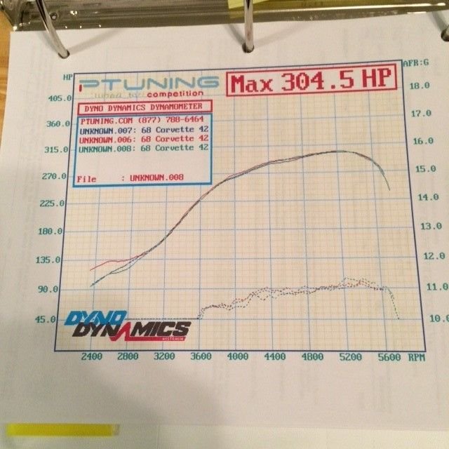

"Ofcourse 13.0-14.0 is a broad range " That range is by manually reading the Innovate gauge, which fluctuates, depending on rpm. After downloading the Innovate software to log my data I found my laptop does not have a serial port for the Innovate cable supplied. Serial to USB adapter is ordered (one more thing to order!) so I hope to have more accurate data soon- probably after the dyno run.
Attached is the printout of the dyno run with the old cast iron peanut port heads, bad filter and bad Mr Gasket regulator. With the restrictive heads this setup was able to maintain ratio in the 11s. When I had the second run done with the aluminum rect port heads, the fuel system ran out of gas, so to speak. I did not get the A/F printout for the second run. Hope they have it archived- I'd like to look at it.

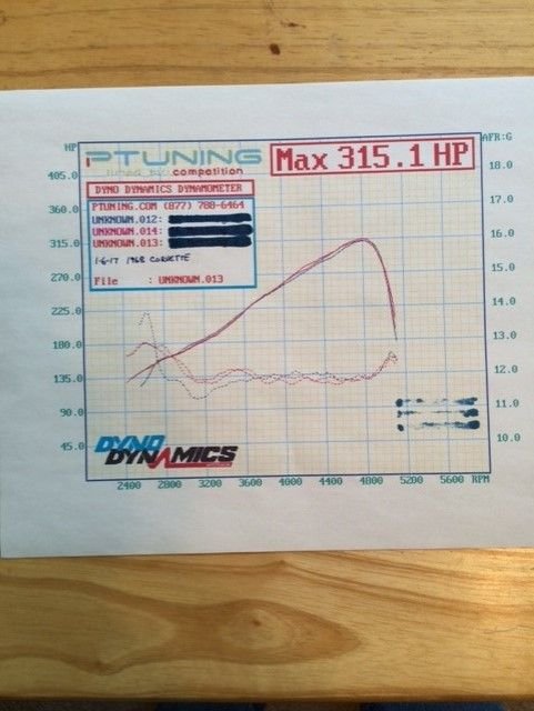

AFR shown in dotted lines at bottom, HP at top
torque shown in top lines, HP in lower curve
Well the most recent dyno run today confirmed the AFR is OK, but the power drop off just as the HP curve starts to take off now suggests ignition, probably a weak coil. So, I have to decide what to upgrade from my old school coil, points and condenser. I have the cheap-*** Chinese HEI distributor with tach drive I bought for about $60, but when I hooked it up, the engine ran like shxt. I can replace the module, coil and magnetic pickup with USA made parts, but I like the smaller size of the stock distributor. Has anyone used the Pertronix Ignitor III conversion kit with the Pertronix 0.3 ohm coil? This would keep my stock size distributor ....... and ..... the carefully measured and installed ceramic insulator plug wires that withstand the heat from my headers. The mfgr description makes it sound like it has MSD properties. Suggestions from people who actually have the Pertronix kit requested.

Well, I'm glad you got your fuel supply issue resolved and your fuel curve looks pretty good.
Now for the nosing over part, honestly, it doesnt really look like ignition to me, the power curve is very smooth, then just drops.
Does it start misfiring or breaking up at the top of the pull? Do you "hear it" nose over?
I'm almost wondering if the valve spring pressure is incorrect and its floating valves, but once again, you can usually see that in the curve and hear it.
Its definitely weird how the power falls off so fast, yet before it was pulling to 5300 or so before it starts dropping.
Keep investigating and trouble shooting, it definitely has something going wrong but, at least you fixed one of the problems.
It looks like you were up about 15-20hp at 4800 before it signed off so, thats a good sign.
"Does it start misfiring or breaking up at the top of the pull? Do you "hear it" nose over?" No unusual noise, misfires or anything. It acts like the coil crashes and the engine just starts to coast due to insufficient time for the coil to re-saturate. First time it happened the technician running the dyno asked if I had a rev limiter installed. The valve springs are double coils rated for 0.6 inch lift- my cam has .540 lift maximum. Hydraulic valve lifters are the Lunati that are matched for the cam. Don't think I have valve float. This problem causes rpms to drop off- like a rev limiter. I suspect the coil is a stock coil that may be getting weak due to age. I think for about $160 I'll try the Pertronix Ignitor III kit.
One problem resolved that I did not mention- a few people said that the rectangular port heads and intake would be too much for street driving and would not have good throttle response. I find the opposite to be true. This setup has excellent low end torque and literally lifts the nose of the car even at 1000-1500 rpm.
