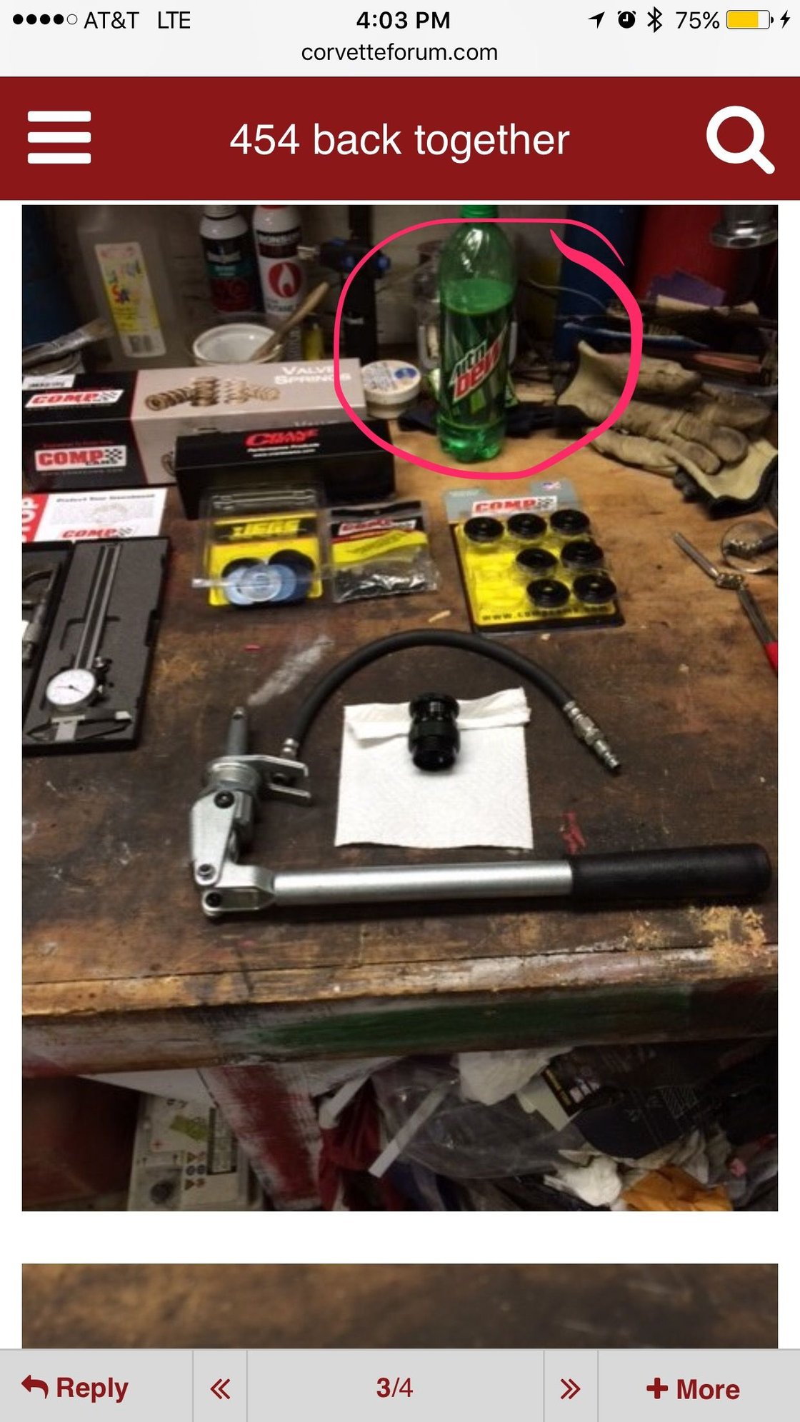

Default valve tool
Originally Posted by ajrothm
BTW I've never seen that Moroso valve spring tool that checks pressures with the springs on the head and rocker arms still on, thats a handy tool I wouldn't mind having.
I need to check my spring pressure, (although I'm afraid to know).... I have about 17k miles on my springs now and I'm sure they are ready....
JEGS is running a special on the Moroso tool- $84.99. If you order something else to get the order to $100, shipping is free. Part #710-62390. Works only on aftermarket rockers, since it needs an edge to grip when you pull on it to get a reading. Works like an old style torque wrench with the spring beam pointer.

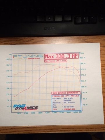

Default final dyno run
68 corvette 454 after installing new valve springs to cure valve float
Awesome job man! Glad to hear its fixed. Hopefully the dyno treats you right..
As per our PMs, I've done the valve spring dance several times and I know how tedious it is but....it HAS to be right.
Good job on sticking with it and working through the issue.
Keep us posted on the dyno numbers.. I'm guessing it does 350 rwhp...
Took the car to the dyno today. Printout is attached. The car pulled strong right up to 6000 rpm for three runs. 338 rwhp and 359 ft lbs torque was a little less than I hoped for, but at least the motor is running properly now. I should have quit while I was ahead, however. The technician running the dyno suggested doing a fourth run -for free- so I said OK. At about 6000 rpm the water pump seized, the fan belt flew off and I got to have the car brought home on a roll-back. You just can't win. So I have my new Autozone water pump and new fan belt on my work bench ready for tomorrow's next adventure in Corvette restoration. Down but not out. RA
Well congrats on solving the RPM problem. I'm sure with some timing tweaking and playing with jetting, you could get another 10-15 rwhp out of it but...its definitely pretty close.
Pretty scary about the fan coming off, that would have been terrible if you or someone else had been standing beside it.
Out of curiousity, was this dyno pull with the air cleaner lid on?
So to recap, you went from 305 rwhp before the rebuild to 338 rwhp after? basically gained 33 rwhp from a head/cam swap. If that engine had about 2pts of compression more, you'd probably be much closer to 400 rwhp. Eitherway, you'll have a fun summer now tearing up the streets.
"If that engine had about 2pts of compression more" Right- I gained about 30 HP (air cleaner off gained 5 hp on this run and also the last run). I considered bumping the compression with domed pistons but did not want to pull the engine to do the balancing act. Since the car is just a weekend cruiser, I am going to resist spending more $$$$ to add HP that I will never use. The car now has a more radical idle to scare off the Hondas and the aluminum heads look impressive. I also have the air cleaner sticker that boasts of 460 HP. Thanks for your help diagnosing the valve spring problem. RA
It's not a happy engine. The HP should not look like a 2 hump camel. That dips tells me it has something that is not correct. You can see it in the decending torque line also. It's either air/fuel, spark, or mechanical.

Am I the only person that thinks this should be making much closer to 400 rwhp?
Jebby
Jebby
Not with less then 8-1 compression I don't think... Plus he had a mechanical fixed blade fan which was costing him 10-15 rwhp.
I think its an honest 350-360 rwhp combo with an E Fan..
Agreed....not bad for 8 to 1 and big rec ports.....
