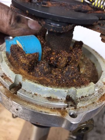

Default well, not corroded quite that bad.....but similar
.............but it was really way too corroded for the conditions it lives in and the care i take. Really annoyed me. I cleaned it all off and lubed it. What garbage. As I menioned earlier my old mallory unilite (which failed after about 10 years of ownership) never rusted at all.... the good thing I can say about the MSD is that it never failed to fire.
THAT REMINDS ME THOUGH---- I really oughta look under that distributor cap again.
Originally Posted by Ryan Menzies
Corroded like this 8571 out of mine ?

I also run the Pro-Billet Tach drive 8572 dizzy and 6AL box. No issues in 7 years/19k miles, other then a SLIGHT corrosion issue about 2 years ago. Mine wasnt nearly as bad as the one in the previously posted pics but...It did have some white corrosion on the rotor/cap terminals and a little on the pick up coil area. It all cleaned up easily and I replaced the cap/rotor.
I've never had an issue with my MSD stuff at this point. My 8572 had the iron gear that I can use with my billet steel cam.
