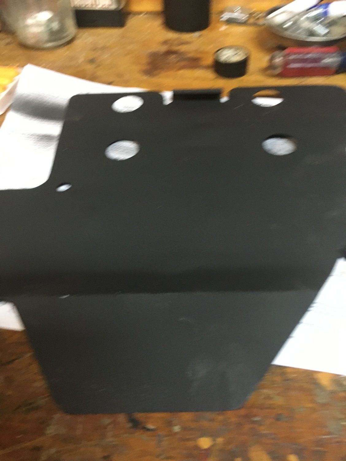

And the what do you need to know about the heat shield???

Originally Posted by DUB
with the above posts X2.
DUB
just wondering how many still have theirs?

Sidepipes; no shield needed
Hopefully most of them still have them. It is a needed part if the car has full exhaust coming all the way out the back. If my memory serves me correctly these heat shields began to be used when the cars started to have catalytic converters.
