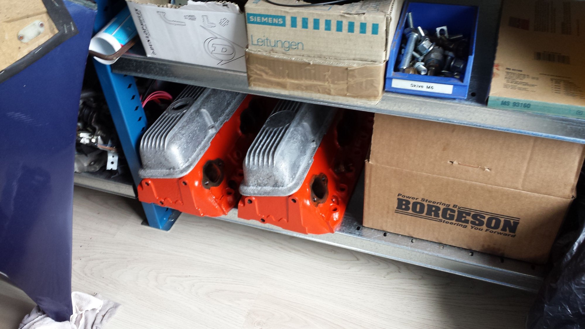

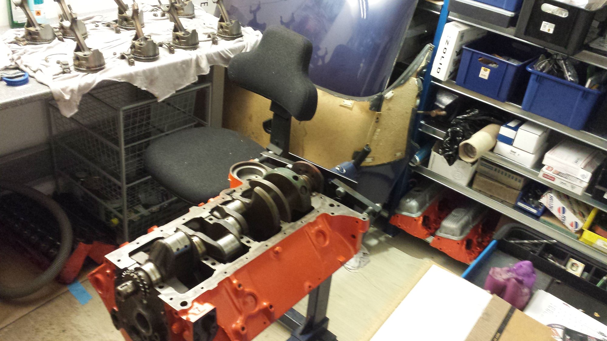

I have 2 set of 1969 L46 heads from 69
Both sets looks like this, and both have 2.02/1.6 valves.
No guide plates and screw in studs.
Other set is under the table.
