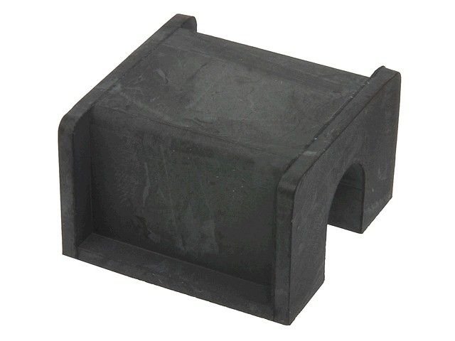

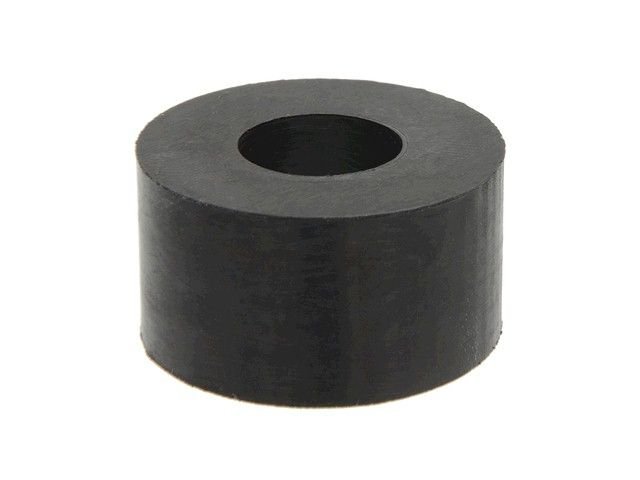

The two lower pins each get one of the round cushions pictured below. The cushions are installed on the pins and then placed in the pockets in the bottom of the support. It usually takes a little pressure to get them to sit down in the pockets, when using new cushions.
The only thing that holds the radiator in place is the top support bracket. The square cushion below is positioned between the top support and the radiator.
