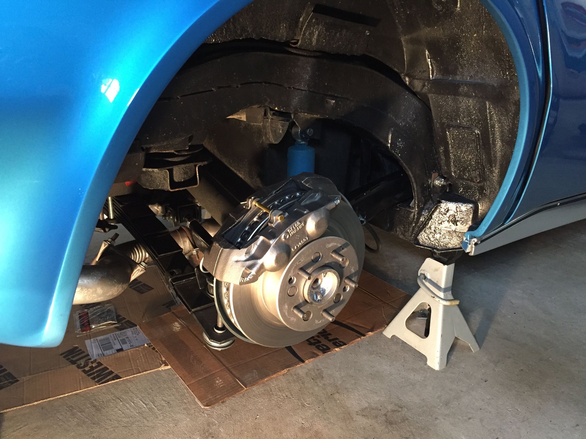

Well.... Finally got trailing arms back in. Had them rebuilt by Blairs. Not a bad removal. I had shock mounts out prior. Those were the toughest part of the job to get out. T A bolts came out fairly easy. Replaced with new stainless bolt/shim kit. New spring and struts. Ended up replacing all brake calipers due to rust, new pads and just about all brake lines. While I was at it replaced rusty master cylinder too. Now clear clean brake fluid. In process of finishing up self wheel alignment. Major job but learned a lot doing it myself. Lots held from this forum by it very knowledgeable members! So thankful we have it.

It is a challenge. But, it is great to work on a car that isn't your DD. No pressure to have it running by Monday morning. Hit a wall, just walk away for the day. I too used Bair's and am very glad I did.

nice job , your car looks great under there.
first rear rebuild job I have seen that has the rivets put back.
