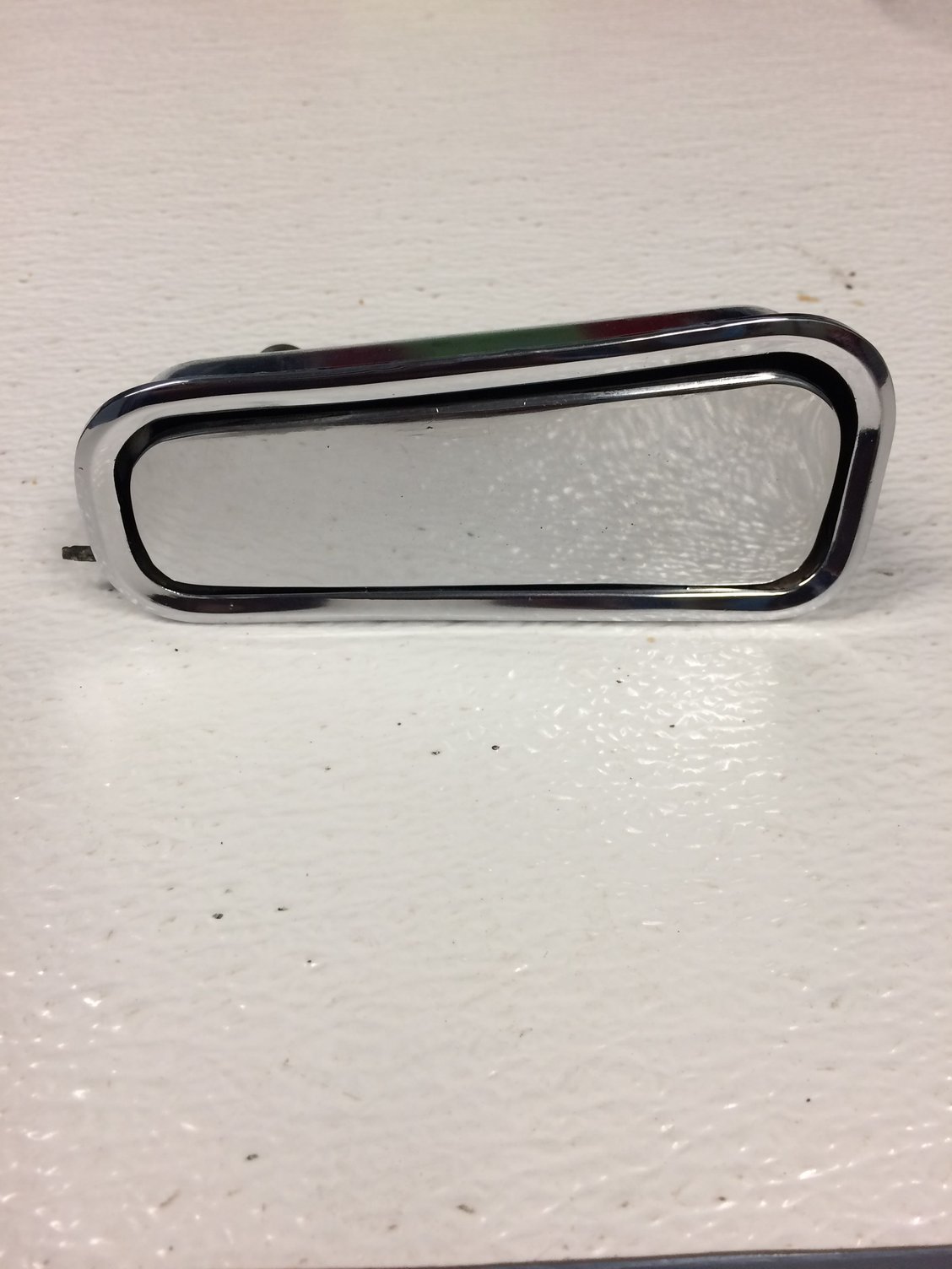

Hinge pin/rod sliding out to cause the handle to be stuck.
Another view of the rod sliding out.

I had to remove the studs from the handle in order to tilt the handle enough to remove it.

WOW!!!! HATS OFF to you Paul.
I must say that is the worst one I have ever seen...and I have had to deal with a few of them doing this.
I would have to keep that one and hang it on the wall in the garage so I could from time to time.... give it a middle finger salute. I have several tings that I have saved that get the respect from me that they rightfully deserve.
