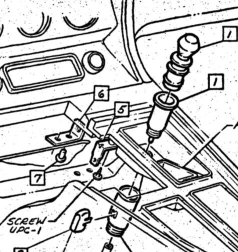

Hi n,
"Not working? Cigarette lighter and lighter lamp,"
Maybe these 2?
Can't be much help because I'm not sure how different your 68 may be than a 71.
Regards,
Alan
Upper arrow…. lighter lamp.
Lower arrow… lighter element connector.

The black wires remain a ground and light up my cigarette bulb when applied to the housing. I did not yet test the lighter.
And I stumbled onto the ground terminal spade. It was bent against the lighter housing and I missed it.
