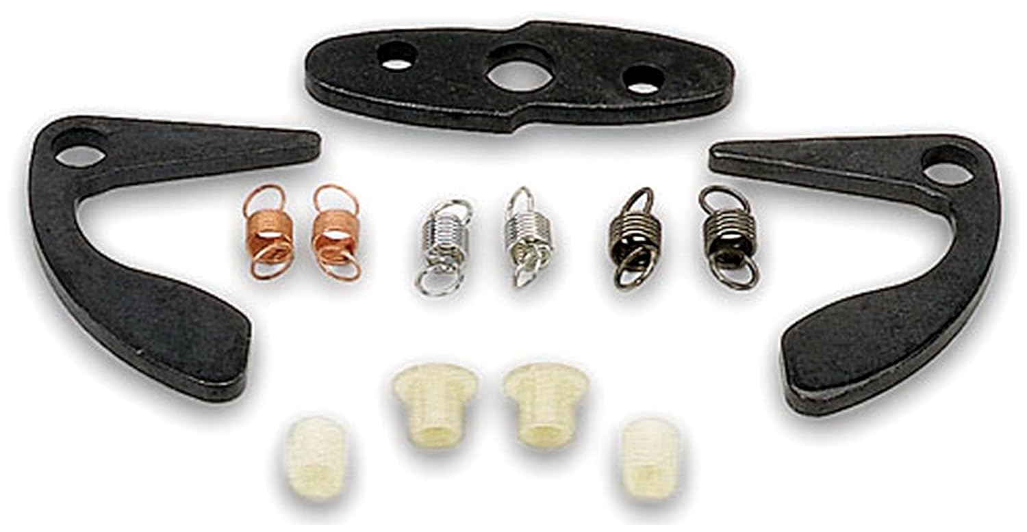

New spring/weights kit should be waiting at home for me to put in tonight. Can't wait to get out of this dang office so I can get them in there. Hopefully I'll have pictures for tomorrow.
Which spring/weight kit did you buy? I've been looking at spring/weight kits and there are so many to choose from from I'm not sure which one to buy?

I got the new weights/springs kit installed. I was completely wrong about what was happening before, instead of having weak springs, the weights were stuck and not giving me much mechanical advance at all. So I retimed to total 36, and now my initial came down to 15. My idle wasn't too happy about that, so I switched the vacuum advance over to manifold vacuum from ported as Lars suggest and it that smoothed everything out at idle.
Incredible the difference in how the car is running. It used to backfire like crazy, now that is gone. Everything is smoothed out, power everywhere.
My question is what issue are people having that makes them complain about their springs not being strong enough? I see plenty of people saying that none of the kit springs were strong enough so they went back to factory springs. Are they having too much advance too early in their power band? If so, what issue is that causing for them? Would that cause the car to run lean? and possibly hot?
I bought this one (mine is HEI ('79)).
https://www.amazon.com/gp/product/B000COO1DG/ref=oh_aui_detailpage_o04_s00?ie=UTF8&psc=1 https://www.amazon.com/gp/product/B000COO1DG/ref=oh_aui_detailpage_o04_s00?ie=UTF8&psc=1
I'm keen for some comments on my advance set up in the video above. The weights and springs should open up and snap back as in KinpenM3's video above but mine don't do that. Do I have worn bushes or something preventing them from working like they should?

spray some lubricant, wd40, under the center shaft so that the cam moves freely. Lubricate the weights and posts with some light oil, 20W.

Pull the weights outward instead of twisting the shaft, then let them go, everything should snap back to the original position.
As far as springs go, I believe a lot of the kits out there are for electronic ignition distributors not points type so the spring rates are wrong and don't work well with the extra drag imposed on the shaft by the points. I tried a Mr Gasket kit I believe it was as it was the only one available here. The springs were too light and the timing would advance too quickly, the engine would back fire through the carb when it was not fully warmed up. I gave up with those springs and fitted some original ones I found on e bay, eventually to get a better adjustment I fitted an electronic advance black box that is adjustable using a laptop and software, I can have any curve I want now. The above is my personal experience with spring kits others may have had more luck!
If you do some research on google it will throw up info regarding spring kits and the conclusion I got from that research was a lot of the kits are not suitable for points distributors.

I have pulled the weights out by hand and yes they do come out correctly and snap back into place as they should. I just thought they should move more freely when you turn the shaft as in KingpenM3's video above? I wouldn't think the advance would work any differently between the 72 distributor versus a later model HEI distributor.
I used plenty of wd40 to clean all the contact surfaces of my weights before I installed the new kit. All kinds of gunk built up in there. Made sure not to leave any excess though, I figure that wouldn't be a good place to start a fire. My kit did come with 3 different size sets of bushings to place in the weights. 1 was so tight it wouldn't go, the other two were loose, but the middle size seems to fit well.
