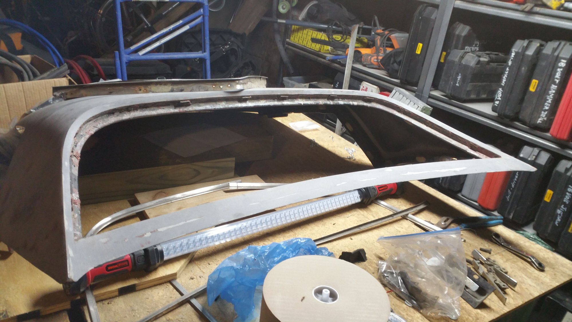

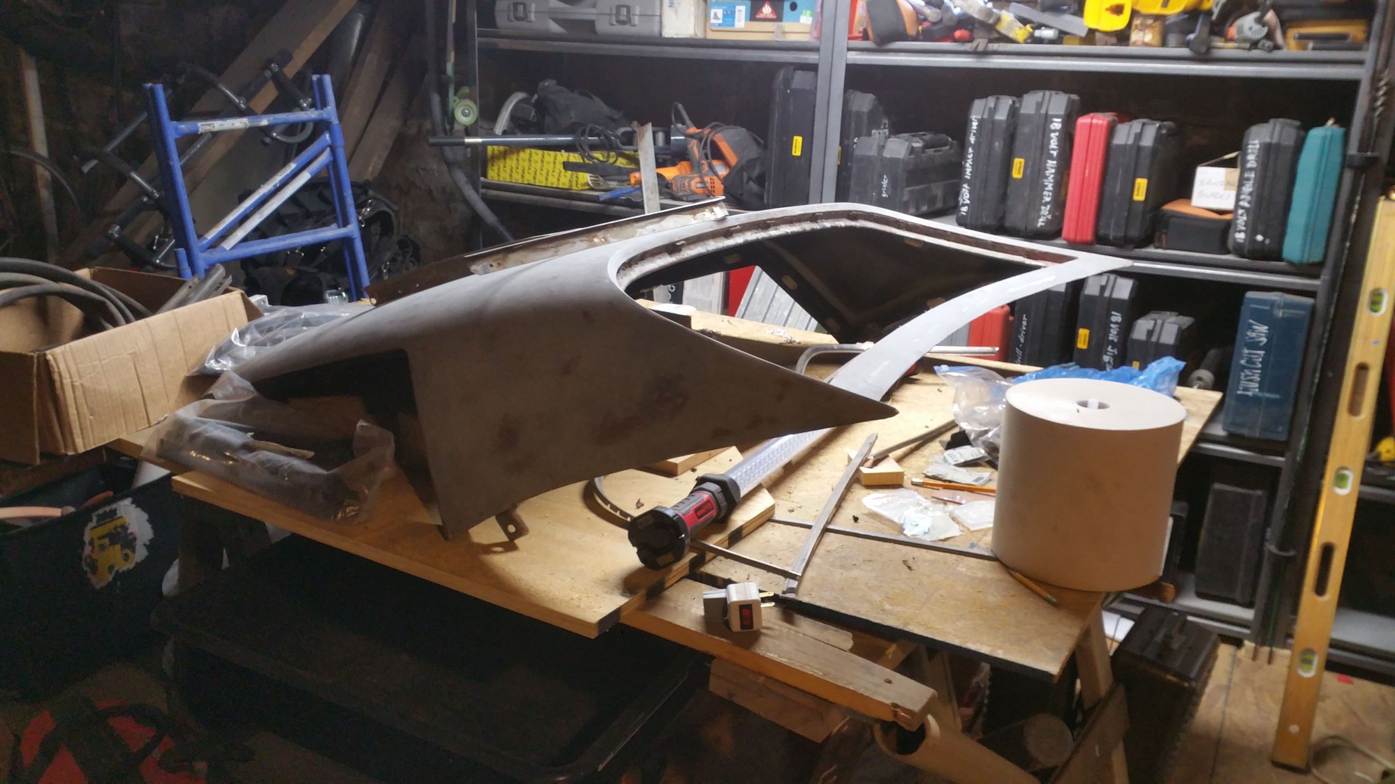

Ill try t get some pics for you tomorrow. My top is all apart. And I am missing a few clips.as well

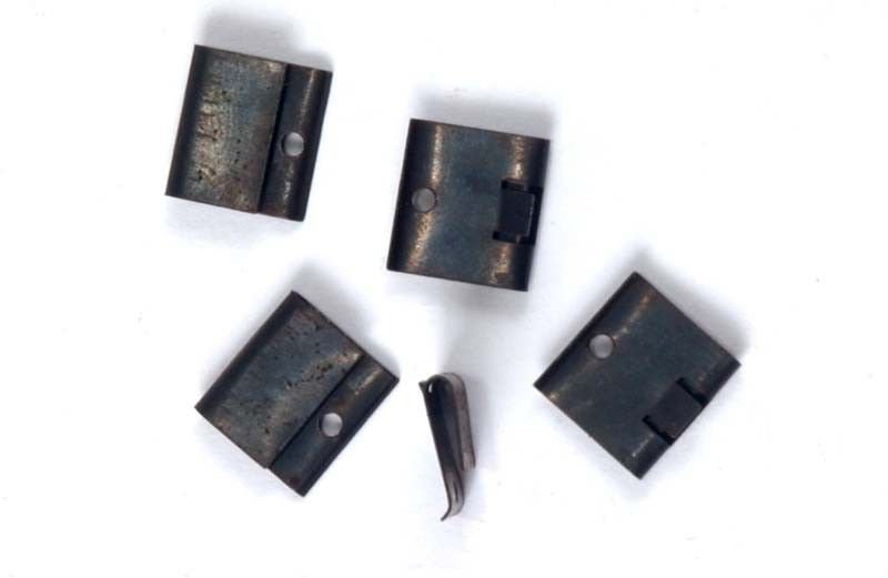

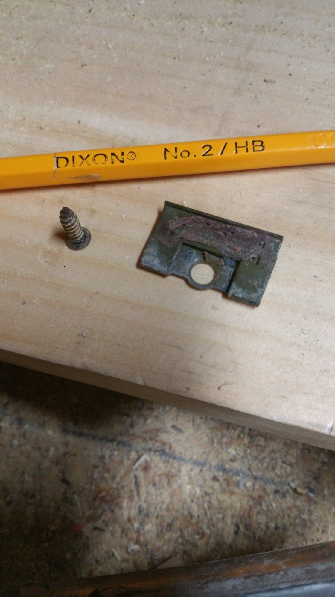

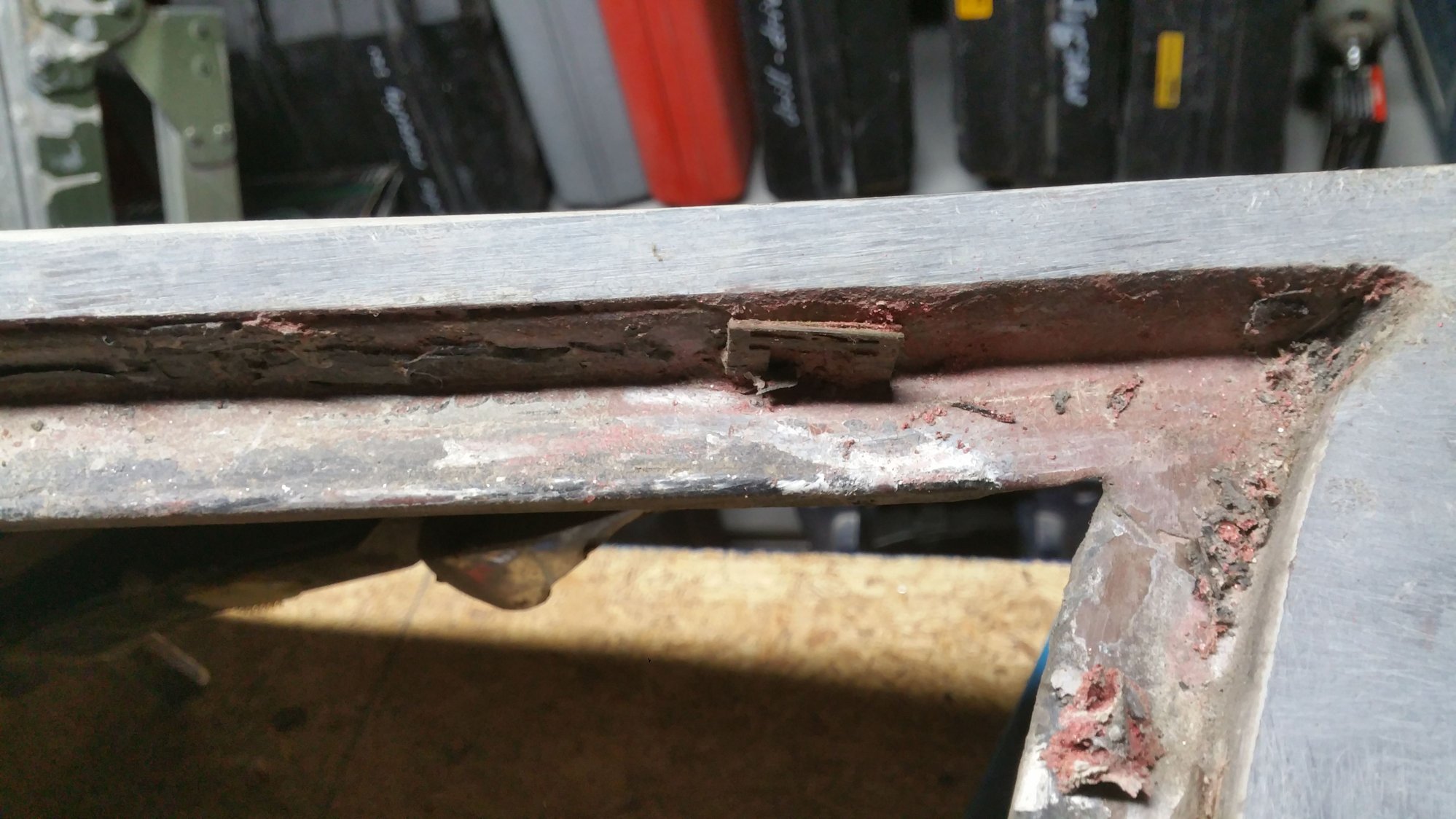

I just picked this up as is. You can see the clips on the edges, yours might be hidden under sealant
If anyone knows where to buy the clips I think I'm missing at least 2

the to picture looks like they modified the trim. it hould go down into that gap. But yes someone could fill that. I found out that the front windshield upper trim clips can be used on the rear window
https://www.volvette.com/ET25J.html

Is this what the clips look like?
http://www.thehardtopshop.com/header...it-13-pcs.html
Good luck... GUSTO

those look too big, look at the volvette link

Theres 18 on my rear window, 6 across the bottom
