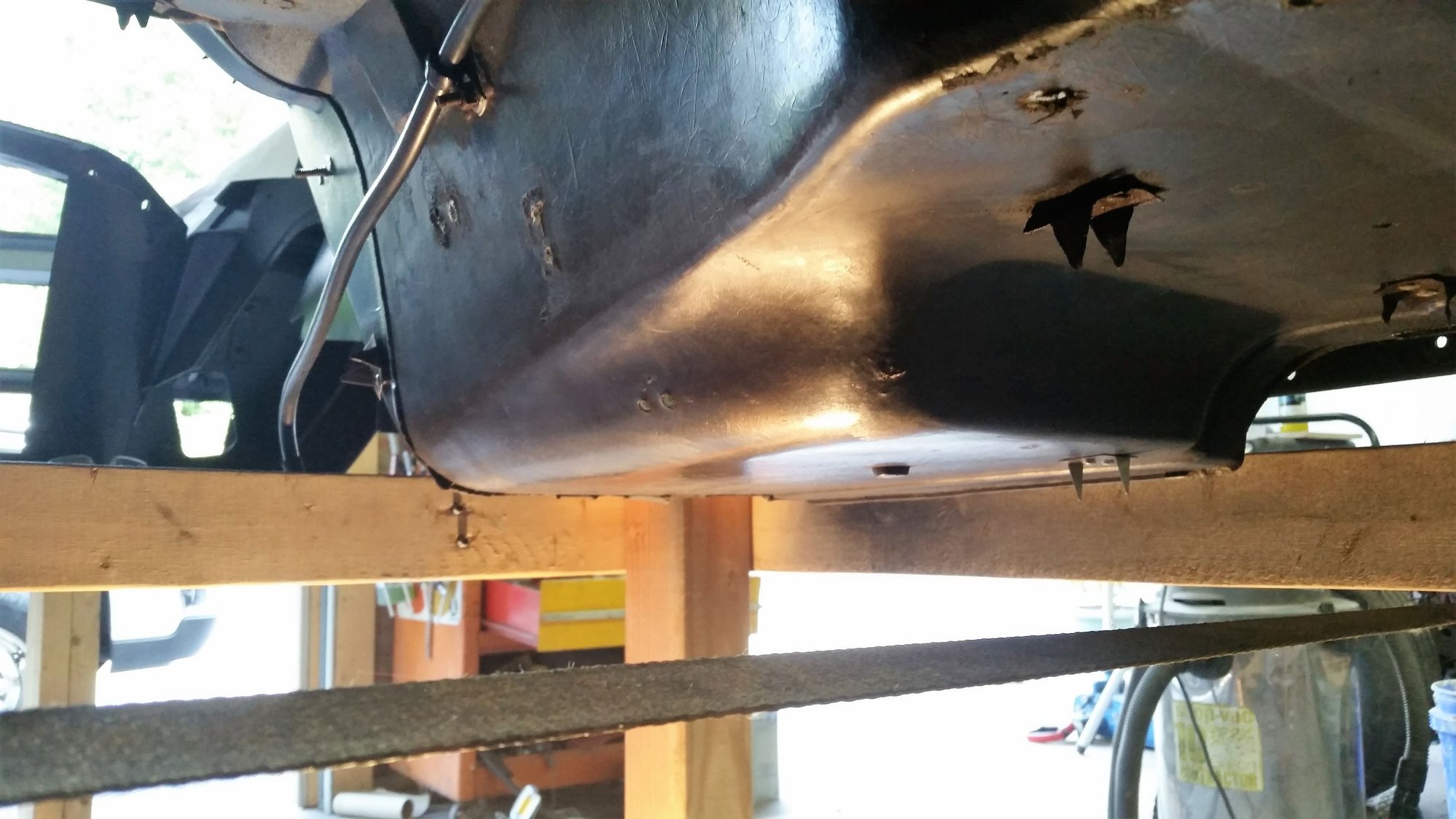

I have a '68 vette. What wires do I need to install before the body goes back on
Old Mar 14, 2017 | 07:20 AM
Easy Mike's Avatar
Easy Mike
Joined: Jun 2000
Posts: 38,923
Likes: 1,481
From: Southbound
Cruise-In II Veteran
Positive battery cable. It's hard to get to with the driveline in place.
At the factory, all the major harnesses were installed before body drop. Your choice as to whether you want to install these before or after.
