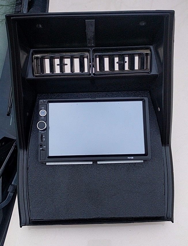

I bought a 12" x 12" x 1/8" sheet of ABS that was textured on one side and fabricated a new front for my gauge cluster to be used to install a double DIN head unit. All of my gauges have been replaced by a pair of 3 in 1 gauges that replaced the speedometer and tachometer.
I got the panel roughed out last night before dark.
The material is easy to work with.
I borrowed the idea from this thread...

Check the thread from user The Punisher that I linked...
He has completed his install and it looked so good that I had to get one, too.

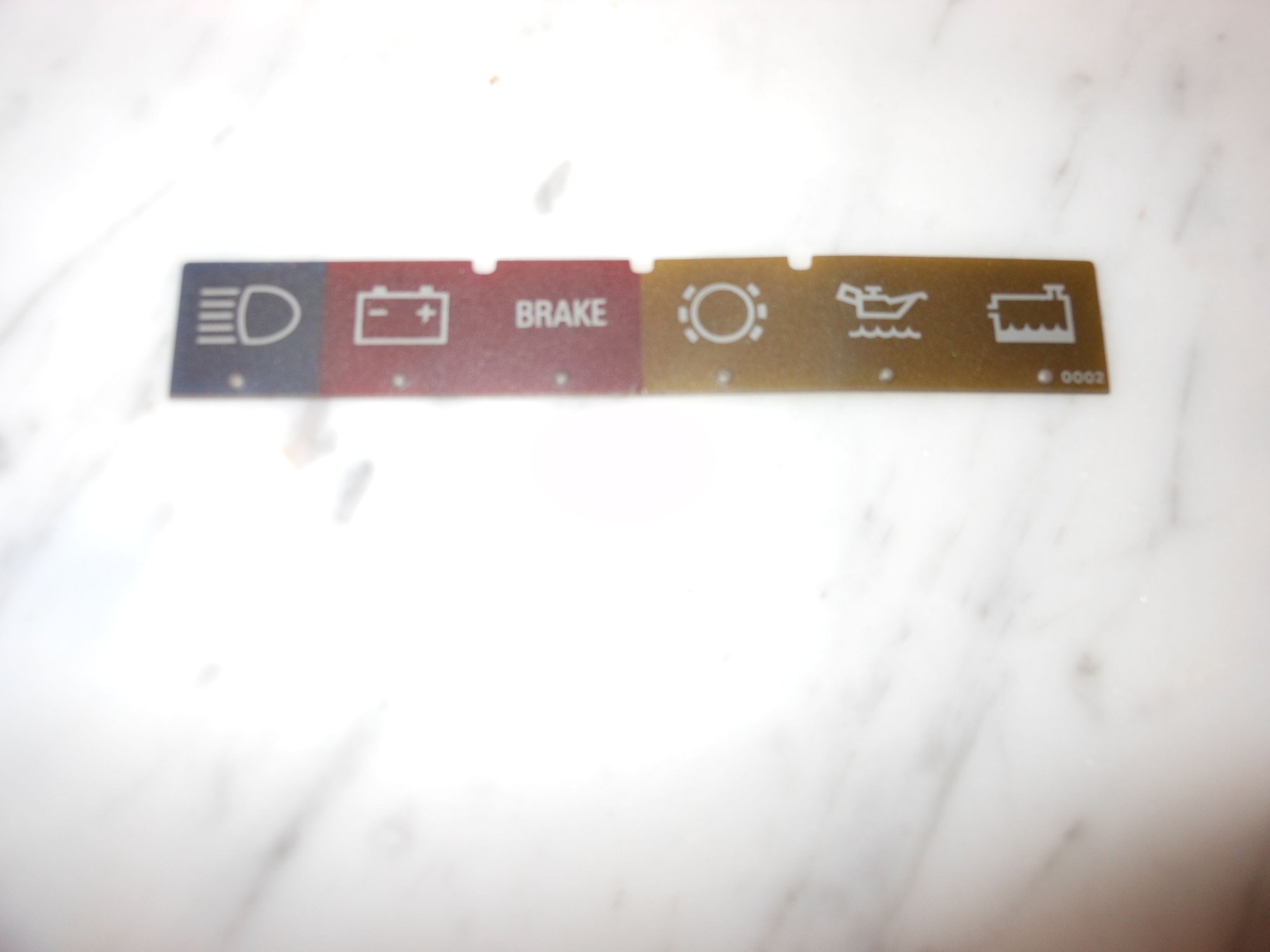

And if you want to do some idiot lights- but don't want a cheesey LED that only you know what it's for...
You can get a square switch-flush mount- several of them on eBay- cheap ones are fine- that are backlit. Pull out the switch and then cover with a dash light symbol. You can get these from a junkyard cheap. I like the late 80's M-B as there are nice and big, fit great plus easy to remove.
