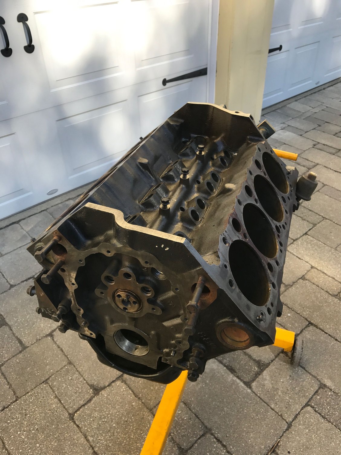

Khibbs's Avatar
Khibbs
Joined: Oct 2016
Posts: 150
Likes: 25
From: Acton MA
F360 - I'm very interested in this thread as I'm in the process of deciding what's going to be the best "recipe" for my 383 build.
Mine will go in an 81 but the intended use is pretty much the same. Street use and I'm looking for usable power. Some weird part of me likes the idea of an engine that will spin to 7k but in reality I'd rather have it pull like a train to 5800.
I like AFR as well but besides that I'm just getting started on what do get for a rotating assembly and what are the best pistons (style and material) for my use. I'd like to be between 9.5 - 10 for the CR as I'm planning on just feeding it pump gas.
Please post up what you find and how it progresses...I'm in the same boat.
My newly acquired late 90s 4 bolt roller block waiting for some parts.

I will be doing the 195 AFR heads for sure, but still searching for the best rotating assembly and cam for my need. I have a matching number and I would like to keep it the same. The block will be the stock one modified to accept the 388 rotating assembly
Another option I am considering is to do a 427 small block engine swap and keep the original 350, anyone have recommendations of a good 427 engine source?
Would not recommend a big stroke SBC. The investment made in getting the headers and oil pan to support the CID along with the induction is a great investment. Also the beefing of the drive line of the C3 can cost serious dollars to support the torque.
If your not opposed to an aftermarket block then I would look at building a 372, 4.125 x 3.48 x 6" rod. You get the rev capability of a short stroke engine along with some CID. A stock style oil pan will support the CID along with a good set of 1 5/8" headers. This stuff won't break the bank.
