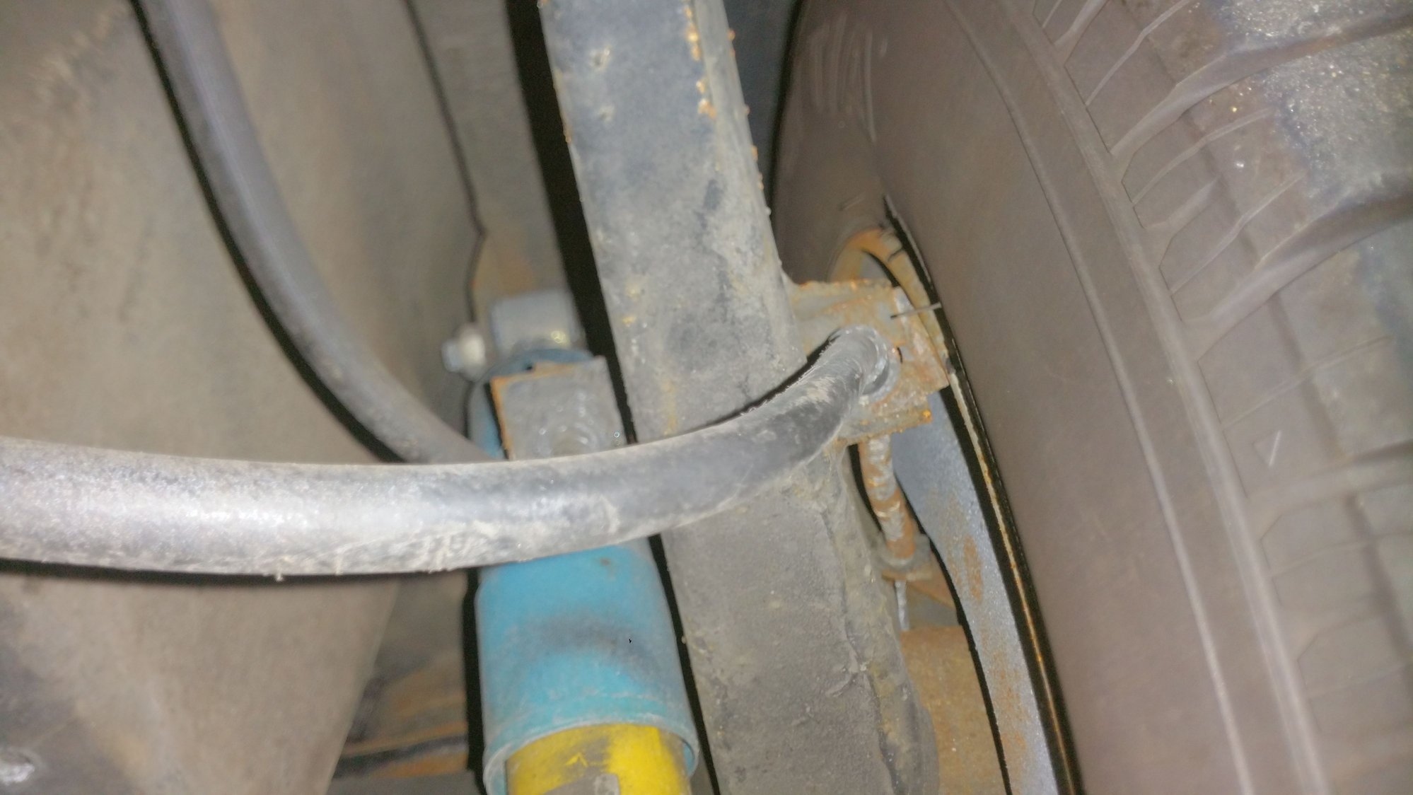

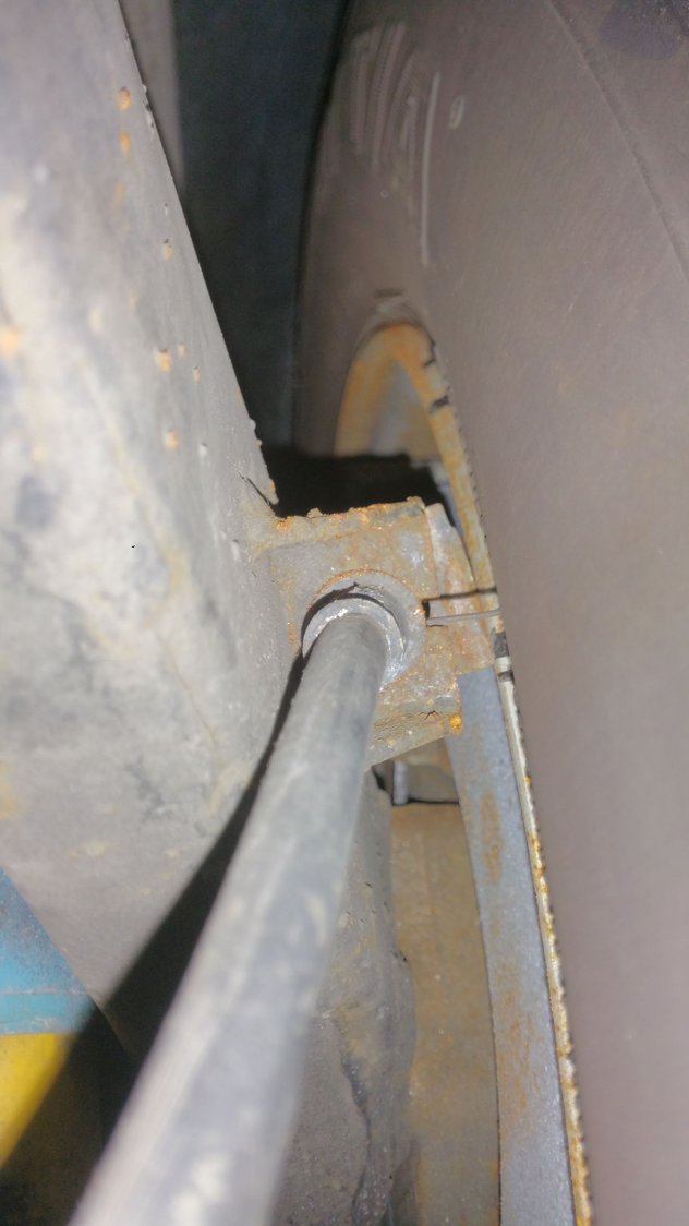

Just do a test fit to be sure it clears the parking brake tab. Mine fit but it only had 1/32-1/16 on the rim and an 1/8 clearance for the tire. I ran it all summer, never a problem
