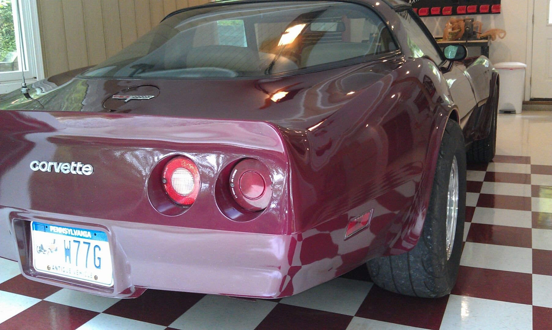

This is the 295/55-15 as of now. As you can see the tire just pokes out past the fender about an inch. Otherwise......perfect.

Just to give you an idea what I have now.....In my opinion, it isn't all that bad. But I figure for what the new wheels cost......I could at least try to improve the fit.
