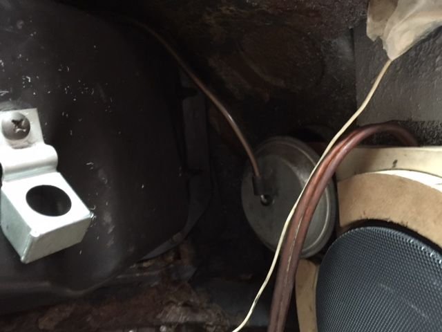

I'm in the process of removing the Heater Core Housing so I can replace the leaking Core in my '73.
As I thought it was just a simple case of removing the 7/16" headed sheet metal screws and pulling it out into the cabin area, I came across this.
One of GYSGT Hartman's quotes immediately came to mind ("WHAT IS THAT??? WHAT THE F#%* IS THAT!!"). It appears to be the wrong end of a stud [] that must be loosened from the other side of the firewall, no? If so, how does one get access to it in order to remove the housing?
Thanks Folks.
Steve

Look on the other side of the firewall.
Old Apr 13, 2017 | 08:33 PM
Duntov's Avatar
Duntov
Joined: Aug 1999
Posts: 1,451
Likes: 84
From: Round Rock TX
That is a stud that has a nut on the other side of the firewall. Should be a 7/16 nut as I recall and may be holding a j clip for vacuum or wire loom. If I recall correctly it's around the wiper door canister.

Therrrre it is.
Sorta hid, but easily accessible.
And you're RIGHT ON with the nut size Duntov. You know yer stuff. The Wire Loom Clip is missing on mine, but I'll put one on in the end.
Thanks to all again.
Steve

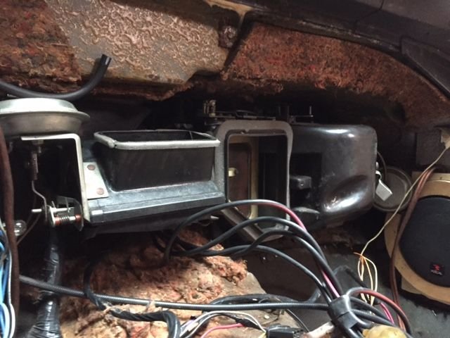

It comes out looking like this.

And 44 years of filth to boot Paul.
Are they repairable? Guess it depends on the damage, and if owner insists on keep it all original. Economically, buying a new core is far and away the way to go, but thought I'd just ask.
Thanks again for the help.
Steve

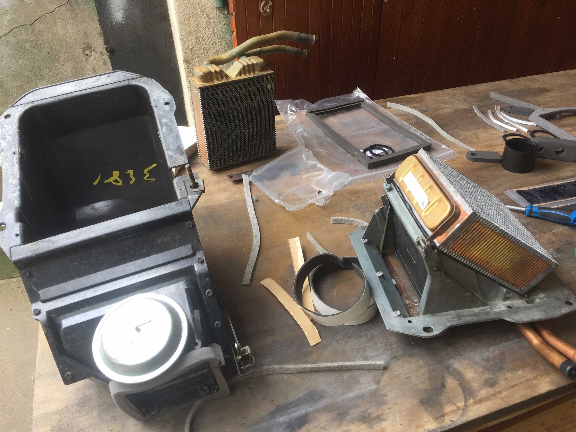

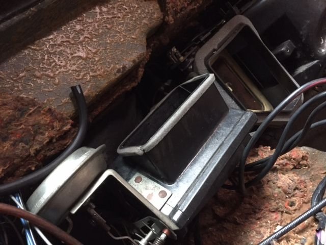

I'll add a few more pics of the box teardown and what I find in there.
Steve

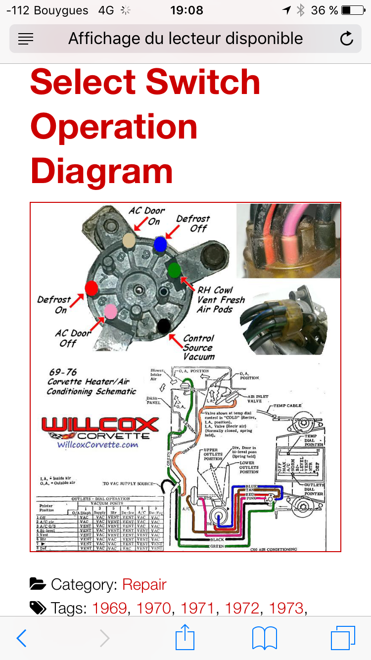

Hello everybody, im new on this forum, my name is william, im an American living in France ^^
Im currently restoring my vette c3 73 since september 2016: my question is :
i can't figure out exactly where does the valve go on which vacuum... i put the pink and tann on the heater box, a guess the red and blue go on the back middle box... but is the red on top or the blue on top ???? anyways, i have problems with the willcox diagram.
Can anybody explain me precisly where the vacuul go .. it really would helmp me out
Thanks everybody, cheers from paris

Hey steve, thank you very much, i
Are you sure, i thought these two went there...
Do you also have an idea where does the blue and red one ??
Thanks again for your response
ps: its a corvette C3 1973

OK OK i just found that.... What do you think ?

Yes. Yellow striped tube goes to silver thing in above picture.
Red stripe tube goes in on top of Box just in front of silver thing. Look inside box there and you will see where it plugs in.
Good luck.
Steve

ok you mean pink not red.... ?
the red one goes with the blue on an other box more on the left..(red on the bottom blue on top as on the diagram) ????
