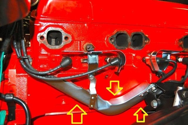

Do you thread the wires through this piece with the arrows below or removing it to thread the wires through? The boots look like they will be a tight fit at best to get through.

Hi JR,
One way that has proved to be a help is to start the spark plug wire at the spark plug… that way you're threading the small distributor cap boot through the 'boomerang' shield.
It also helps get the wire through the engine mount by working from the spark-plug and threading toward the distributor.
Sometimes removing the boomerang is a problem so try working from the spark plug first.
Regards,
Alan
