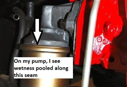

I borrowed a portion of Alan's fuel pump picture for illustration purposes only! This is where my pump is showing signs of leaking. Thanks Alan for your pictures.

Right above that seam there are a couple of small holes- vents for the diaphragm, Diaphragm leaks, fuel gets out thru those holes and that seam gets wet.
The bolt you remove and install a longer bolt in is also in that picture..
