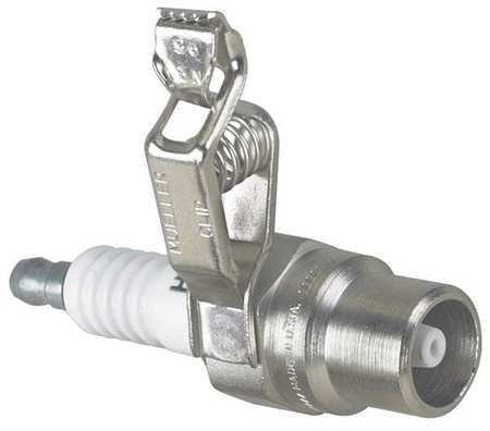

Interesting. It did seem like the spark was intermittent.
Do you have a spark tester? The spark can't be weak, it needs to be able to jump a good gap.
There are many other brands of testers around, I like this one for it's clip.
This one can go inline with the spark plug wire.
Thanks. I don't have one but I'll pick one up today. That looks like a real handy tool.

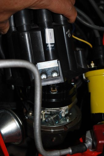

Here's what's happening this morning....
I set the timing to about 8 degrees BTDC as shown in the pic. And I also made sure to hit the 8 degree mark during the compression stroke. I know this because I moved the crank after the intake valve had closed. I checked the spark plugs and they are wet with fuel. I also checked the plugs for spark and it's happening.
Then I pulled the distributor cap to see the position of the rotor and it was pointing to cyl #1. Notce the silver mark I made on the distributor to know the position of cyl #1.

And it goes 18436572 CCW?
http://www.hotrodders.com/gallery/da...ring_Order.jpg
Have you tried starting fluid for giggles?
Points open about .018" top of the lobe?

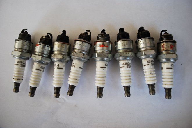

Here's what the #3 spark plug looks like:
I'm going to pull them all out and clean them. I'm also going to let the cyl air out over night as you suggested.
I'm going to pull them all out and clean them. I'm also going to let the cyl air out over night as you have suggested.
I would install a fresh set, squirt in starter fluid, and start it up.

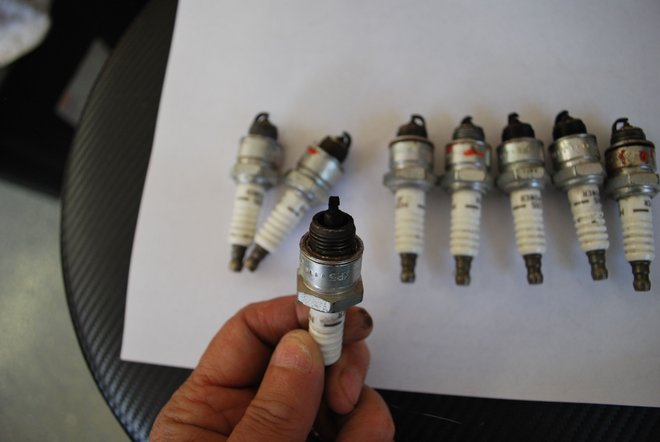

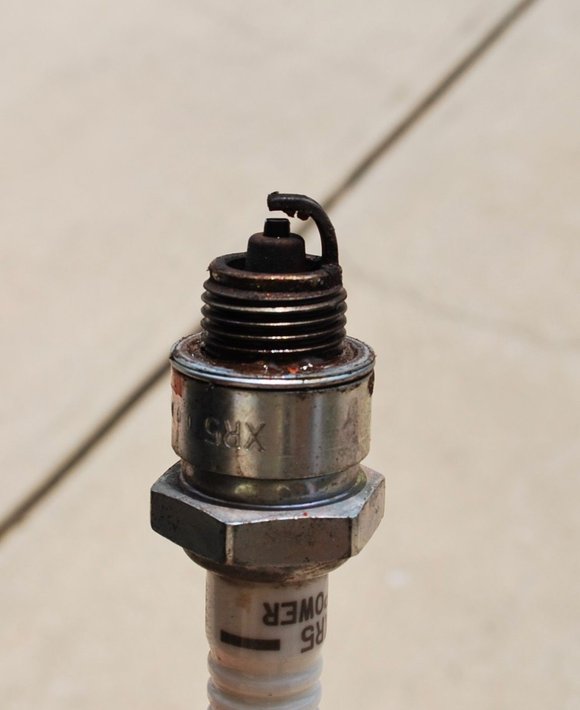

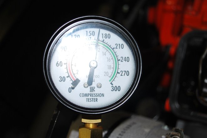

Okay here's where I'm at with the no start saga...
I pulled all the spark plugs and yes they are covered in some black oily muck that is covered with gas. The spark plugs are not more than a few months old and show very little wear. This is not surprising since I don't drive the car much. I did spin the engine over a few times as suggested and I didn't see any fuel coming from the cyl so that's a good sign.
I'm not going to bother with cleaning them. I'm going to the parts store in morning and picking up a new set.
While I had all the plugs out I ran a compression test on #1 and it doesn't look too bad in my opinion.
More to come...

You have been running rich as well.

Compression looks good. Like Big3Bird said you've been running rich too. Might want to lean the idle mixture screws a bit before trying to start it back up. Once you get it going you can always go back and adjust.
