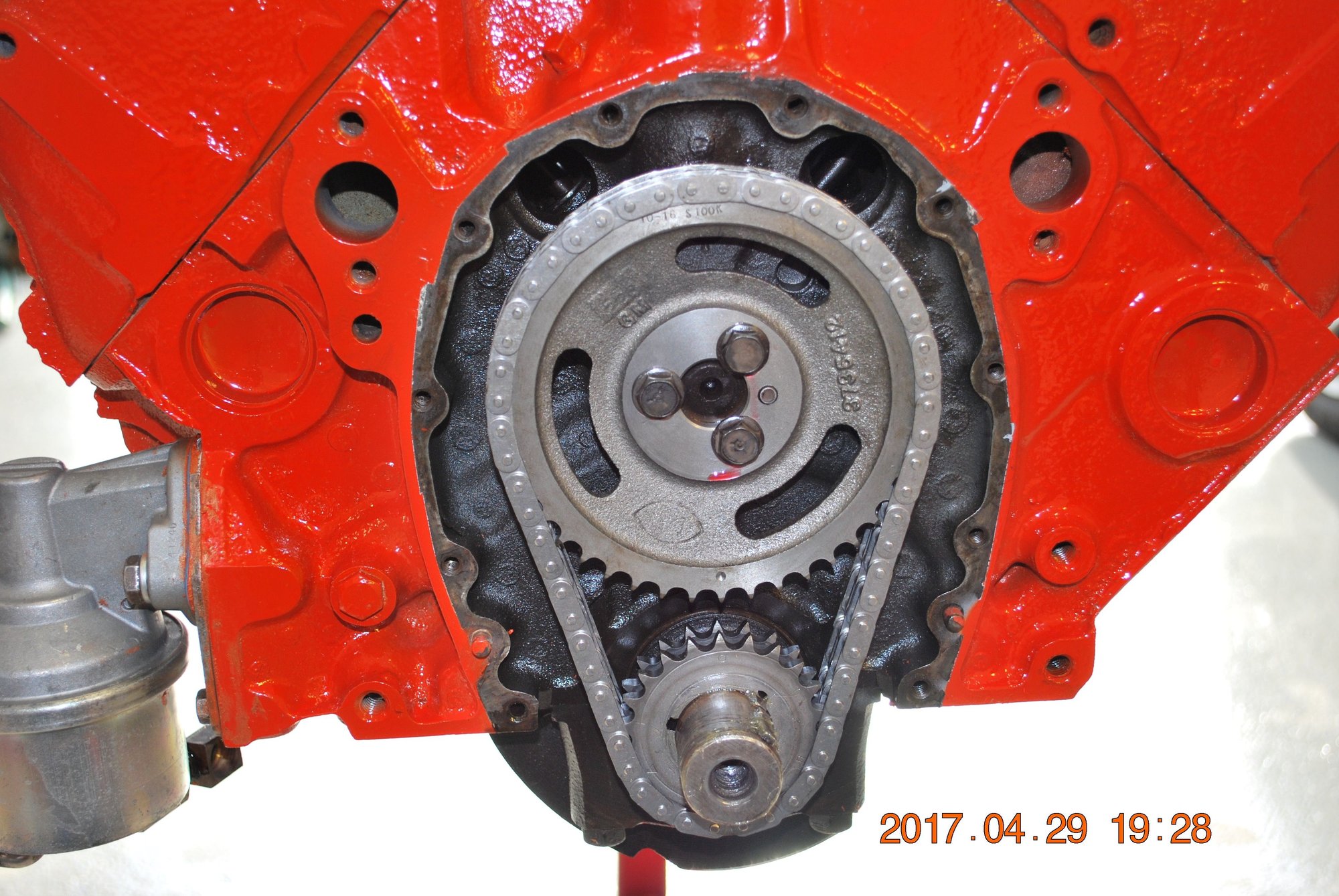

I only rebuilt 2 engines back in the late 70s, but I remember my cam sprocket and the crank sprocket index dimples lined up -crank at 12 oclock, cam at 6 oclock, but I was working on pre-'68 engines....

I did the same dimple lineup on this one:
This engine has always been difficult to start. I have to pump the pedal several times before it cranks. I'm not sure if other owners with similar engines have to do the same.
Anyway, I'm not sure if my next move is to replace the spark plug wires -- it's the only thing left to change.

Are you sure you got the right dot on camshaft gear? According 77 service manual, the dot is not like that. My 2 cents.
