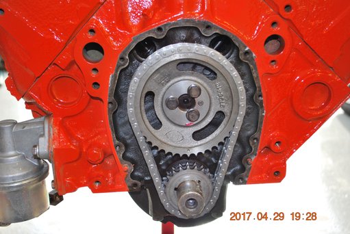

If you set the new timing chain and gears so the cam gear was at 6:00 and the crank gear was at 12:00, it's in the firing position for #6. If you dropped the distributor back in and set it for #1, it's 180* out. Been done before.
You make a good point and yes the cam gear is set to 6 and the crank gear is set to 12, see pic. This is what I did to set the distributor. I turned the crank until I saw the intake valve on #1 open. I then continued to turn the crank until the TDC mark was at zero. At that point I reinstalled the distributor and had it pointing to #1. Did I make a mistake?

Timing chain looks good per your picture, so that is off the table.
