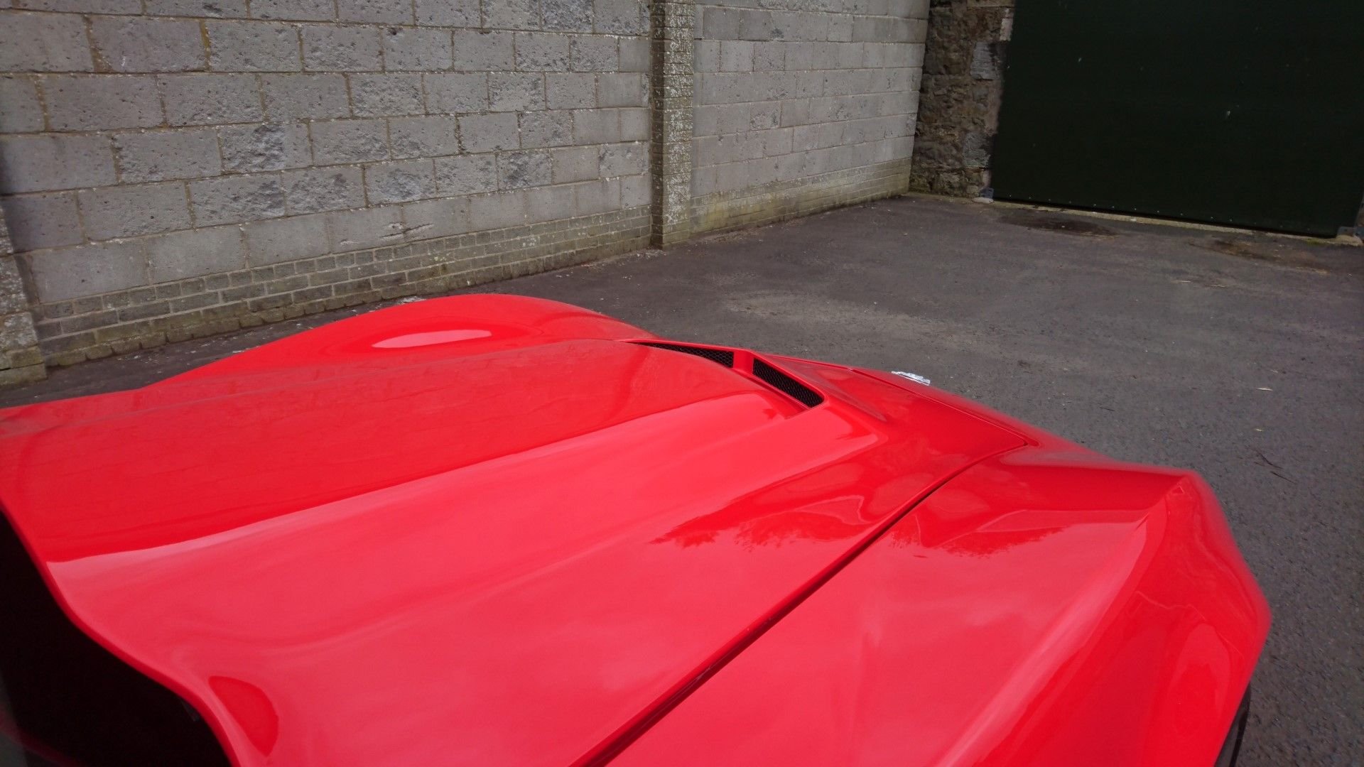

like this you mean ?? ive cut hole so a lip is on the bottom to catch some of the rain, so doesnt just poor in, not sure if its helping cooling things?

I have wondered the same thing .I think the cut outs look great .

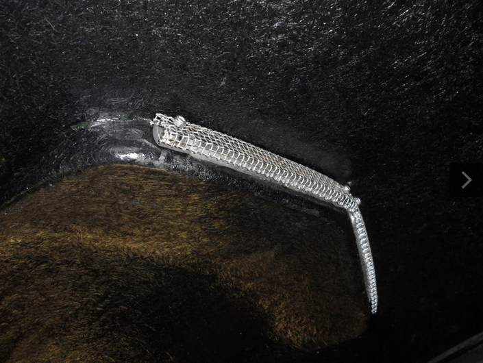

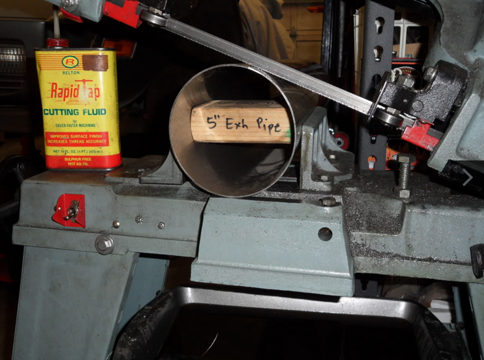

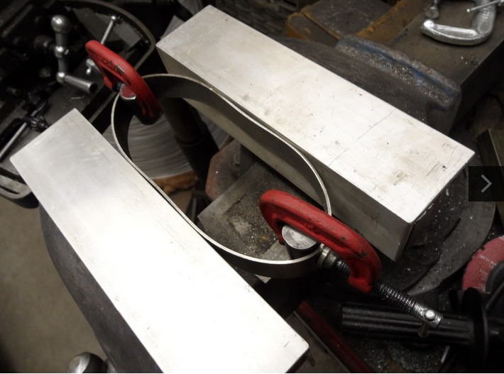

Yes they do,
So richard, any idea what the inserts on tg5e silver grey car are from
He (AKA fellow forum member- "rpol98" ) "used 1" slices off of 5" stainless exhaust tube, After squishing it in a vise, the slots are just over 3/4" wide.
Used some 14-ga stainless sheet for the face plate, and some stainless wire mesh.
EPDM foam rubber gaskets on both sides, nyloc nuts."

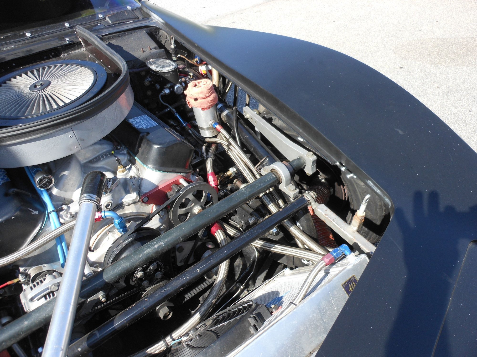

Not if you mount the radiator like this-
I'm working on a cold air in and heat out hood right now...I'll keep you posted.
Can only do that by changing the bonnet hinging arrangement though (note bonnet pins in pic). Look forward to seeing what you come up with, I've been thinking about a heat/pressure extraction hood myself.

I like the inserts on the red car. Looks much cleaner.
I was thinking about something like this but wasnt sure if the headlights would still be functional, and now that I see a pic the radiator hose would be the first obstacle to get around clearing the hood for traditional mounting. (not a fan of hood pins)

Originally Posted by Metalhead140
That radiator is right where the front of the hood goes when you open it. You'd have to either go to a complex hinge (that lifts the bonnet up as it opens) or a rear hinged hood if you wanted to retain hinges with that radiator location. As you note, room might also be limited for headlight actuators or motors.
I had looked at doing this type of radiator set-up.
There's a couple of options
This one is only about 10" tall- or you could do like the a lot of the kit car guys are doing and run two small radiators- one on each side- angling in towards the center of the car and down.
Re-arranging the headlight's "arm" to place an electric motor out of the way is not an issue at all.
Do you know whose car this is or what those bars crossing the engine compartment are for?
It was at the Walter Mitty-Road Atlanta this year...It's a funky torsion bar front suspension- looks just like my Chevy Avalanche's but upside-down!!!
