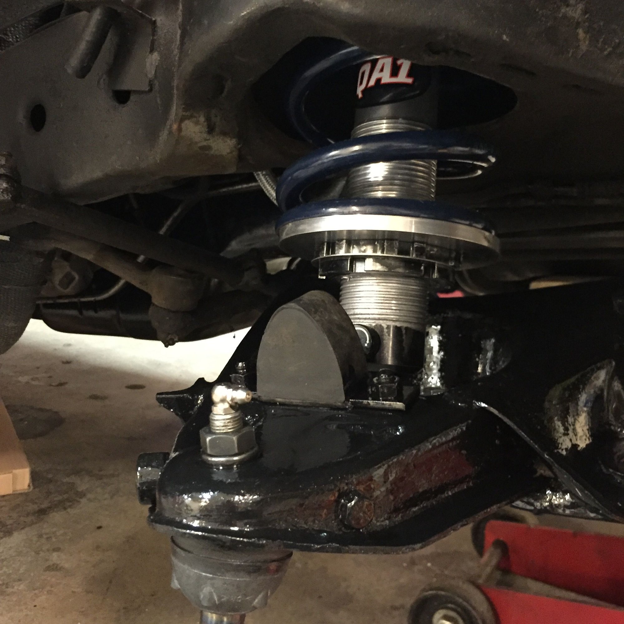

I got Qa1 and it made all the difference! Super easy to install and rides like a new car

I have removed the rubber bottom out stops front and rear. I don't jump my vette up in the air like a dirt bike. It is unsprung weight. I think that your shocks would be bottomed out first
