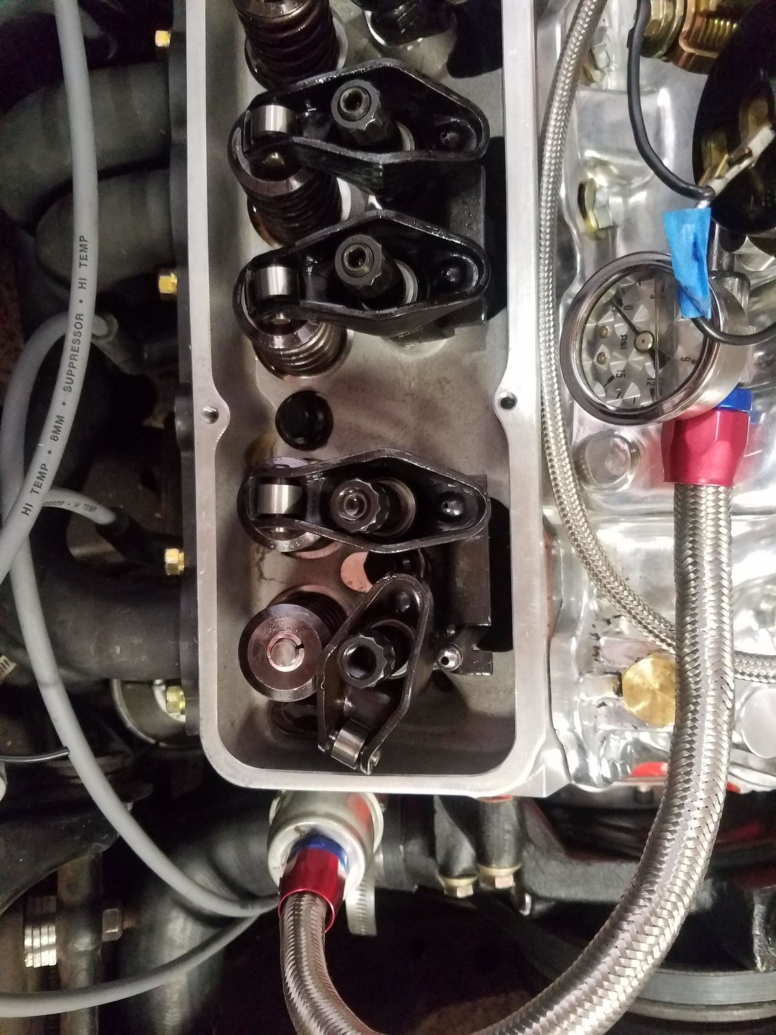

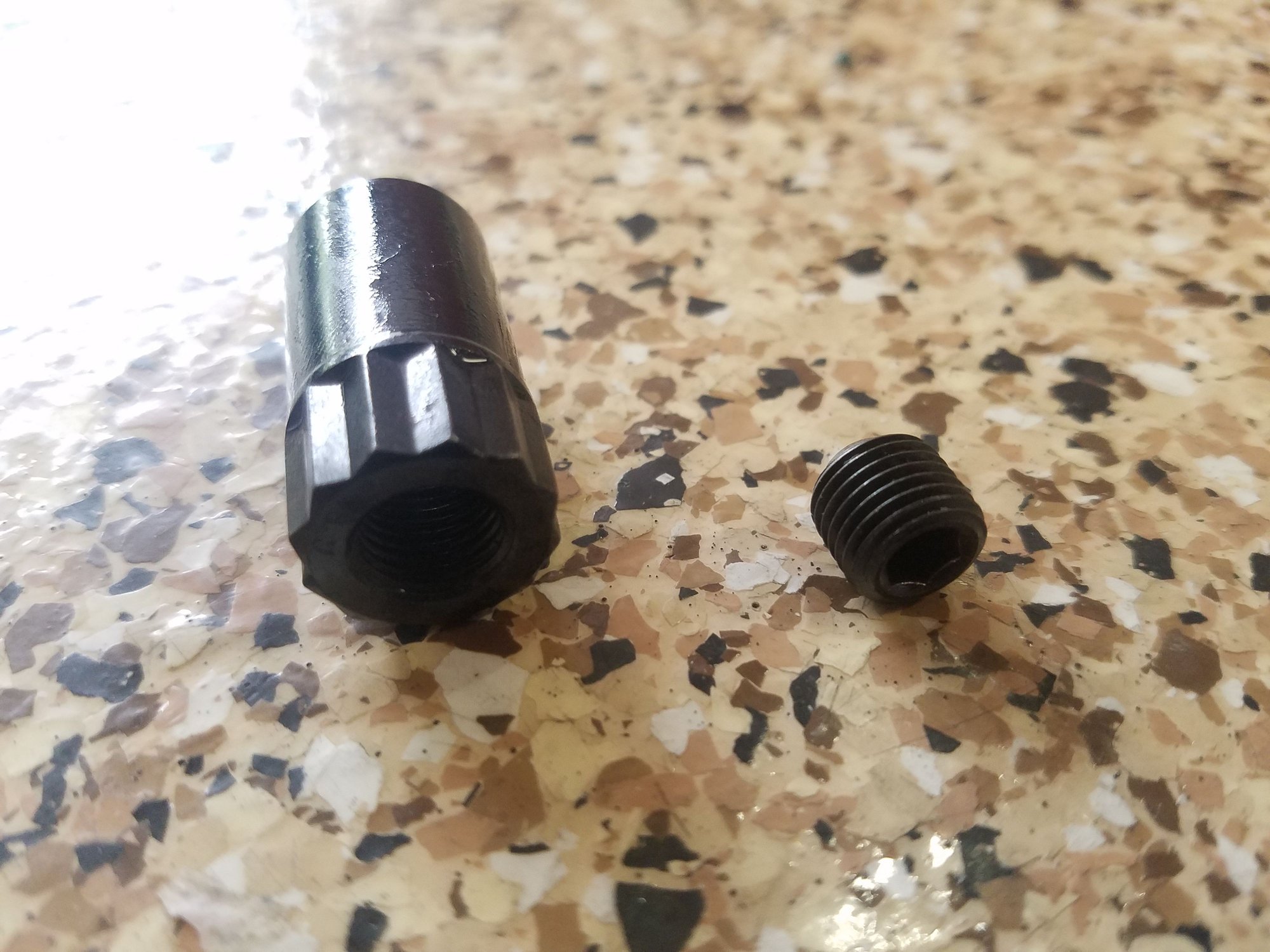

So first off, my spark plug wires were pretty wacky (Realized I used a wiring diagram for a different engine ) so I rewired them and it runs, but it misses backfires like crazy. So after a bunch of troubleshooting, I opened the valve covers
So I have no idea what happened. My locking nuts apparently came apart? Luckily those little set screws were all recovered and none went into my engine. But so I'd say that's probably why it wasn't running right.
I'm sorta lost on why that would even happen and what to do now.

sometimes if you crank them down too hard the top will split and the lock will back out ,,if its not split ,, lock tight helps

you have to reset all of your valves first

When you set the polylocks, don't just set the nut, then tighten the setscrew. Tighten the nut, then back off about 1/16 turn, then tighten the setscrew, then TIGHTEN BOTH THE NUT AND SETSCREW TOGETHER. Until you start doing it this way, you'll fight loosening nuts all the time.
